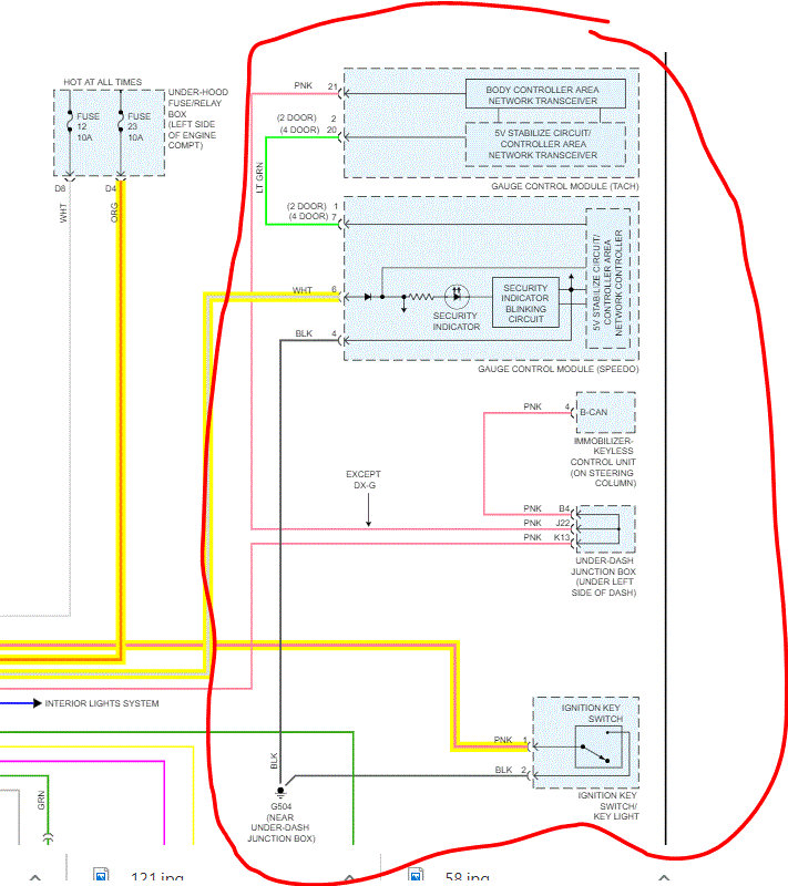

BABY2016
Just got the ignition re-keyed and programmed as well as a new battery. The car cranks and runs but the security light flashes, hazards flash (no horn) and the car refuses to go over 35 mph. What can I do to reset this without having to go to dealer?
Aug 8, 2020 at 11:06 AM (Merged)
  • CAR REPAIR CONTRIBUTOR
  • 110,190 POSTS
Since the security light is flashing, my first question is if the reprogramming of the key was done correctly. That light should be off if the car recognizes the key. Have you spoken to the person who did it for you?
Next, what really needs done is to have the computer scanned to identify diagnostic trouble codes specific to the anti theft. Here is a video that shows how it is done:
https://youtu.be/b2IJGfImVvw
I realize most people don't own a scanner, but often times a parts store will do it free of charge. Often times they will either rent or lend one to you if the vehicle isn't running or safe to drive.
I mention having it scanned because there could be many things causing this to happen. There really isn't a reset or anything like that other than if it is done with a scan tool capable of communicating with the vehicle's computers.
I mentioned if it was done correctly because there are many things that can be causing the problem. Not trying to be confusing, but if you look at the two pics I attached, you will see only a few things that control the anti theft. Without a diagnostic trouble code, it becomes a guessing game and I wouldn't want you to replace parts that are good. In all honesty, my first suspect is it needs reprogrammed.
Please feel free to ask questions.

BABY2016
There is not green key icon showing in the dash as to where the key doesn't match. That's what is confusing me. It also cranks and runs (but only up to 35 mph).
  • 110,190 POSTS
A green key is what you need. Did this just happen since the key was replaced?
BABY2016
Yes, the car ran before it was parked and key was lost.
  • 110,190 POSTS
I hate to say it, but it needs reprogrammed to recognize the new key. Have you spoken to the person that did the work the first time?

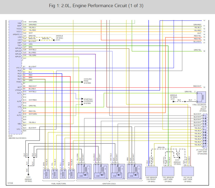

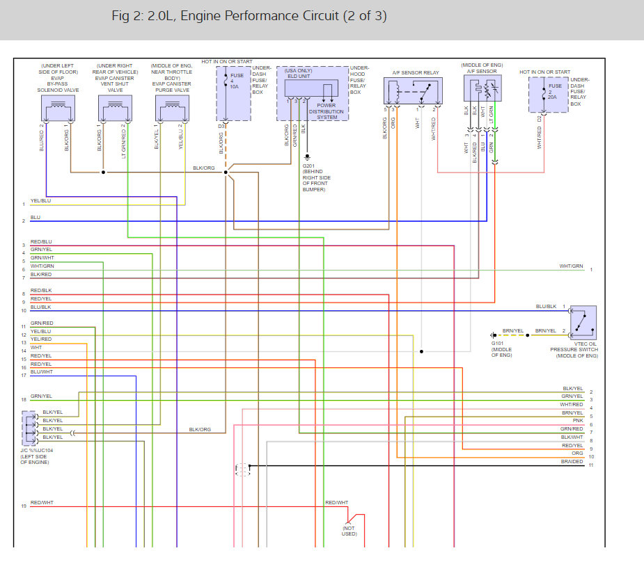

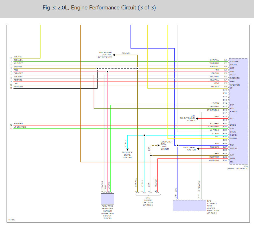

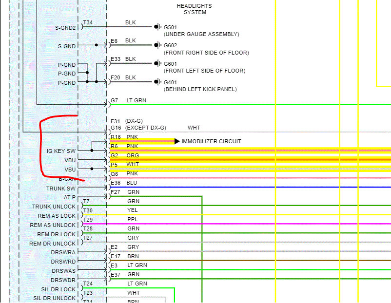

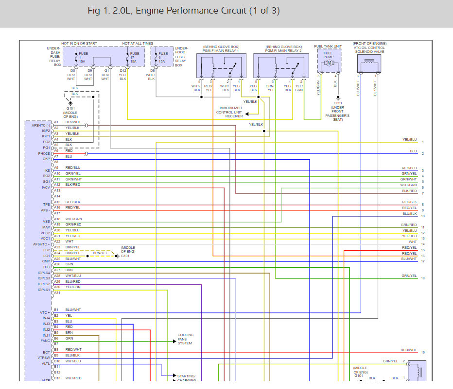

HBSB2CARPROS
  • 19 POSTS
I have the car listed above EX model, four door sedan.
The check engine light is on, the immobilizer light is flashing, there is no communication with the scan tool. The tachometer is inoperative, the temperature gauge is inoperative.The car runs sluggishly, no acceleration, engine cuts out (bogs down) at higher rpm's greater than 3,400 (when tachomdeter was working).
DLC test:
With the key on or off and ECM's p31 unplugged from the ECM, and measuring voltage from dlc pin 5 (logic ground for ECM) to chassis ground, I get a nine volt reading. With ECM's p31 plugged into the ECM, (key on or off) and measuring voltage from dlc pin 5 to ground, the reading is zero volts. Why does this happen? Is this normal? How does the logic ground function in relationship to the ECM?
Aug 8, 2020 at 11:10 AM (Merged)
MMPRINCE4000
  • 8,548 POSTS
It sounds like you have a bad ground I would check them all by using this guide and the engine PCM wiring diagrams below.
Cheers
DEECEE0283
  • 5 POSTS
ok will do that thank you

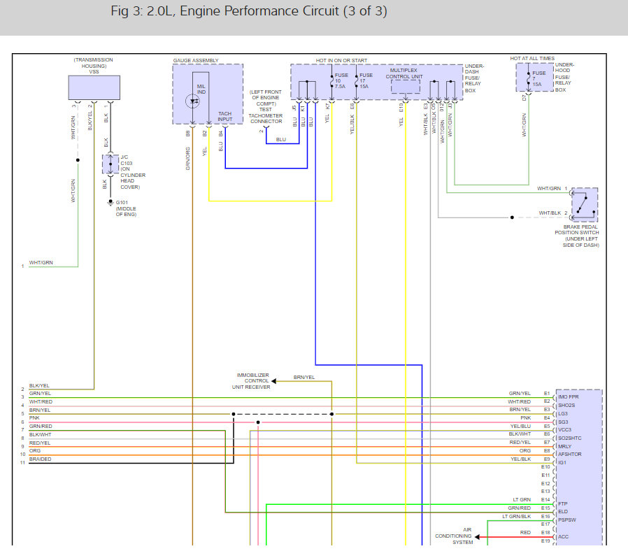

HBSB2CARPROS
  • 19 POSTS
I am stuck having to fix this problem myself because neither the Honda dealership and two other shops were unable to fix this. Definitely appears to be some kind of wire (electrical) problem.
MMPRINCE4000
  • 8,548 POSTS
Troubleshooting:
Turn the ignition switch ON (II) with a programmed key.
Check to see if the immobilizer indicator comes on.
Does the indicator come on?
YES - Go to step 3.
NO - Go to step 12 .
Check the immobilizer indicator operation.
Does the indicator come on for 2 seconds, then go off?
YES - Go to step 4.
NO - Go to step 6 .
Try to crank the engine.
Does the starter motor operate?
YES - Go to step 5.
NO - Check the starter motor.
Try to start the engine.
Does the engine start?
YES - If available, check the Status Log in the Immobilizer info with the HDS (see STATUS LOG ). If the Status Log is not available, the Immobilizer system is OK at this time.
Check the diagram below.

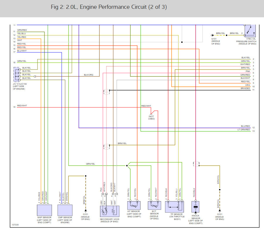

HBSB2CARPROS
  • 19 POSTS
I did find the TPS voltage at the ECM would not measure any higher than ~1.7 volts. I get five volts at the TPS plug, and was able to measure 6k ohms of resistance on the TPS. I was also able to vary the throttle valve and notice the resistance vary on the TPS. I realize the TPS can still be non-linear and still be causing problems. I am having with this car.
Thanks for the accurate wire diagram, I could easily follow out the wires, their color etc. Found the bad ground and got is fixed the car runs great! I love this site.
