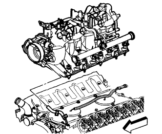

I dont know if the price is fair but the intake gaskets are $100.00 and the it takes about 3-4 hours to do.so you might be looking at about $400-$500.as far as doing it yourself I dont really know,these arent that bad to do.
https://images.2carpros.com/forum/automotive_pictures/147643_intake_1.gif
