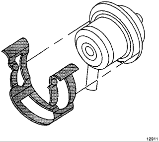

Hi, I'm about ready to change the fuel pressure regulator. In my chilton repair manual it says that there is a vacuum line connected to the fuel pressure regulator, but there wasn't a vacuum line connected to it when I pulled the upper plastic manifold cover off. Is a vacuum line supposed to connect to the fuel pressure regulator on this vortec 350?

Hello – I need more specifics on your vehicle to better assist you – is it a C1500 or C2500 or ??? What are the exact Liter size of your engine and the 8th digit of your VIN.

My truck is a C1500 with a 5.7 liter V8. The 8th digit of my VIN number is the letter R.

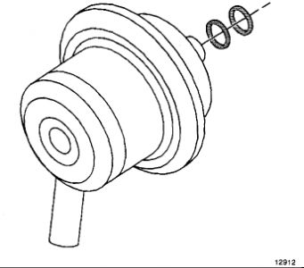

Hello – sorry you are having problems with your vehicle.
According to the attached information – as you see, yes a vacuum hose is supposed to be connected. You can see the hose hook up on the attached diagrams. Also, I attached the directions and it states the same.

REMOVAL PROCEDURE
Disconnect the negative battery cable.
Relieve fuel system pressure. Refer to Fuel Pressure Release Procedure .
Remove the upper manifold assembly. Refer to Engine Mechanical .
DISASSEMBLE PROCEDURE
Disassemble the fuel pressure regulator snap ring retainer.
Disassemble the regulator assembly and the O-rings.
Discard the O-rings. NOTE : If the fuel pressure regulator is to be reinstalled, inspect the filter screen (if equipped) for contamination. If contaminated, remove. Discard the filter screen.
ASSEMBLE PROCEDURE
Lubricate the new O-rings with clean engine oil.
Install as an assembly, backup O-ring, large O-ring, filter and small O-ring.
Assemble the regulator with vacuum tube pointing down and snap ring retainer.
INSTALLATION PROCEDURE
Install the upper manifold assembly. Refer to Engine Mechanical .
