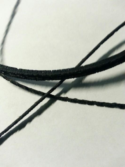

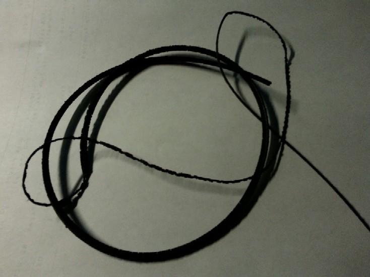

My temperature indicator always stayed at a constant position (about half way up). The other day, for no particular reason, I happened to glance down at the gauge and it was almost at the H level (all the way up). I opened the hood and noticed the reservoir was empty and there was green coolant all over the passenger side area on all parts around the reservoir. I bought a gallon of coolant and poured it in the reservoir. It took almost a full gallon less about a cup or two. No water just coolant, as it is cold here in NJ, and I had been topping off the reservoir with water in the warm months, because I had no coolant available and I didn't need to worry about freezing.) So, I thought maybe there might be something frozen in the cooling system causing a blockage. I let it sit for a few moments and then took it for a drive. The gauge stayed normal for a few minutes and then started creeping its way back to the H level. I pulled over and noticed the reservoir looked almost empty. I was close to home so I drove it home and then let it run and looked under the hood. The plastic reservoir was full and coolant was "forcing" itself out of the sealed pressurized cap on the reservoir. It was bubbling out at a very fast rate. I thought radiator, water pump, or blockage in the system somewhere. It was dark and I had a flashlight. I was ready to close the hood, when I noticed this type of metal stringy material near the air cleaner system toward the driver side of the engine. I looked at it and grabbed it and pulled it, and the material that I managed to pull off looked like belt material reinforced with bands of some sort of strings of metal. So, I thought it must be a belt that operates the water pump. Trouble is, everywhere I look on the Internet, says the main serpentine belt drives just about everything in the engine, including the water pump. So, my question is, what is the material I pulled off that looked like part of a belt and is that the cause of the engine overheating and bubbling out of the cap on the plastic reservoir? I didn't have a chance to look at it today in the daylight, but hope to work on it tomorrow. I need to replace whatever that "belt" type thing is, and find out why the system is overheating. (A side note: for about a month, I have noticed as I pull into a parking lot, and look at the road where I pulled in, a line of liquid in spots about the size of a silver dollar spaced about 5-6 inched apart. In other words, something was leaking out slowly as I drove, but didn't notice it until I would park and see these spots as if something was dripping slowly out as the engine is on.) When I am parked and the engine is off and cool, there is no puddle under the area where the plastic reservoir is, on the ground. The images are just a piece of what I pulled out, not the full size of the belt or whatever it is. Can you guys figure that out?

Picture didn't show up. If that's part of the belt, the water pump is likely slipping and a new belt is all that's needed. The coolant will build up pressure to 15 psi, then it will push into the reservoir, and that can overflow and make a mess. You have to check the pulleys though too. If any pulley is sloppy, turned, or tipped, it will shred the new belt the same way.

Yes, they are part of a belt of some sort, but not the main serpentine belt thats on the passenger side. I looked everywhere on the net, and could find no reference to a separate water pump belt. Is there actually a belt there where I described closer to the driver side? It does have a plastic rounded cover / housing over it, it seems, to prevent anyone or anything from getting caught in it. In the daylight I will look tomorrow and see if it's a belt and see how difficult it will be to put a new one on. Also, I will remember about the coolant and the combustion gases. I just don't know why I have not seen anything mentioned anywhere about a smaller separate belt, away from the large serpentine belt. It's definitely all ripped apart and not causing whatever it is connected to to operate. Thank you very much. I am going to the Social Services tomorrow to get General Disability assistance because I cannot walk. If they approve it, I will make sure I come back and leave you a donation soon, because you provide an invaluable service, and I'm sure most of the people do not donate, which they should if they have the money. Take care.

I use the Rock Auto web site for reference a lot. They DO show a smaller belt for the water pump, but I didn't look if there's a difference between the single and twin-cam engines.
The pictures showed up. I can't say for sure, but it kind of looks like the belt is dry-rotted. That would cause if to break apart in strands like in the first picture. Shredding on the side is caused by a tipped or turned pulley that forces the belt to ride against the lip on the side of a pulley. A single break is caused by a sudden shock from a locked-up pulley, usually the AC compressor.
Maybe you can sew the pieces back together!?

hahaha!! This is just a smal piece of what I could pull off. SO, there IS a separate belt over by the driver side then! I wonder why I couldn't find any mention of it anywhere, not even parts places like auto zone and advance.
I'll just cut the bad one, not much left to cut I would gather, but getting the new one on is a different matter. They didn't leave any breathing room in those big Vulcan Duratec 6 cyl 24 Valve DOHC 3.0L EFI engines. When that thing kicks into OD on the highway, it's a rocket! You should have seen the de-assembly / assembly process I had to go through to put a new brake booster and master cylinder on it!! And a new blower motor for the fan,heat and A/C under the passenger side dash was just as bad!Thanks for your help. Keep up the great work. Going to Social services now.
