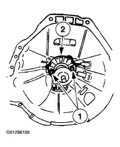

I am in need of directions on where the slave cylinder is located so I can replace it.
Monday, November 17th, 2008 AT 8:58 PM
MHPAUTOS
MECHANIC
31,937 POSTS
Hi there ,
The clutch slave cylinder is in side the bell housing and the transmission must be removed to service it.
