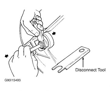

Is there a special tool used to connect the clutch cable to the transmission, one person told me yes and one person told me no.
Monday, May 24th, 2010 AT 7:26 PM
BLUELIGHTNIN6
MECHANIC
16,542 POSTS
Yes..you will need special service tool T88T-70522-A , pictured below
