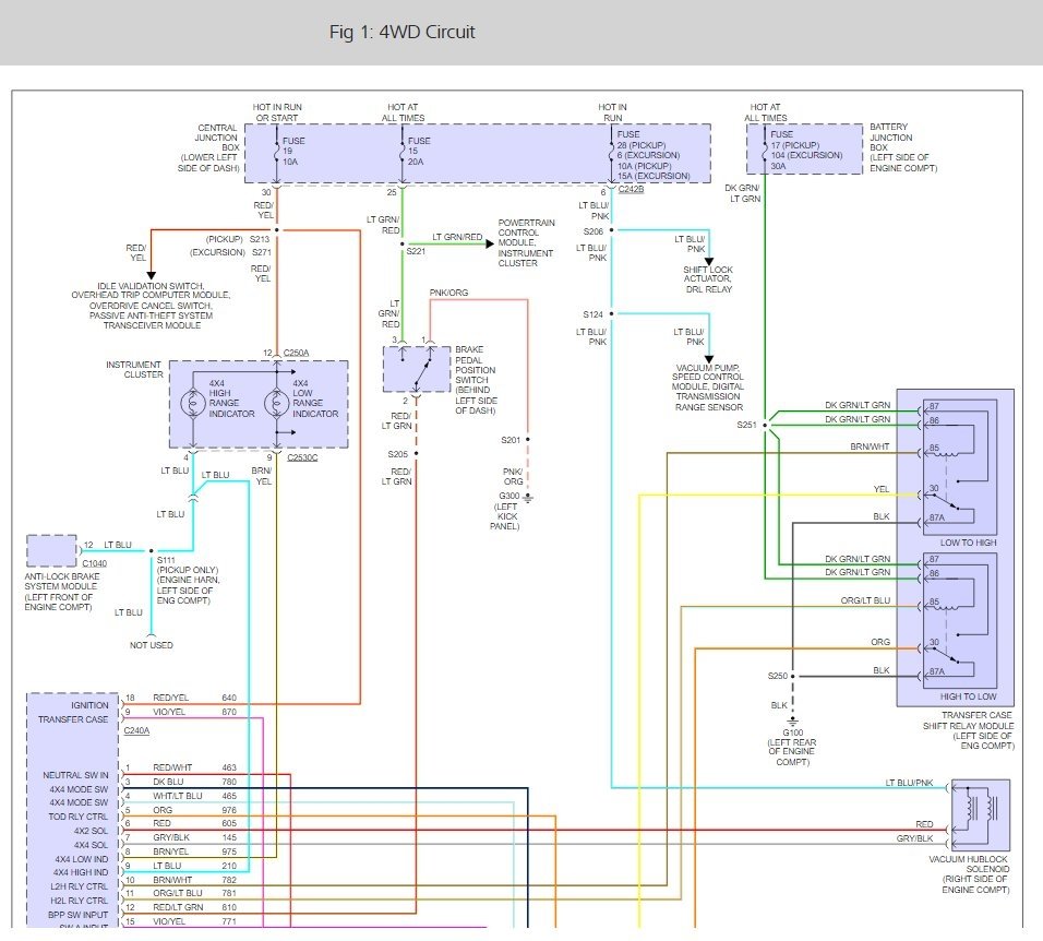

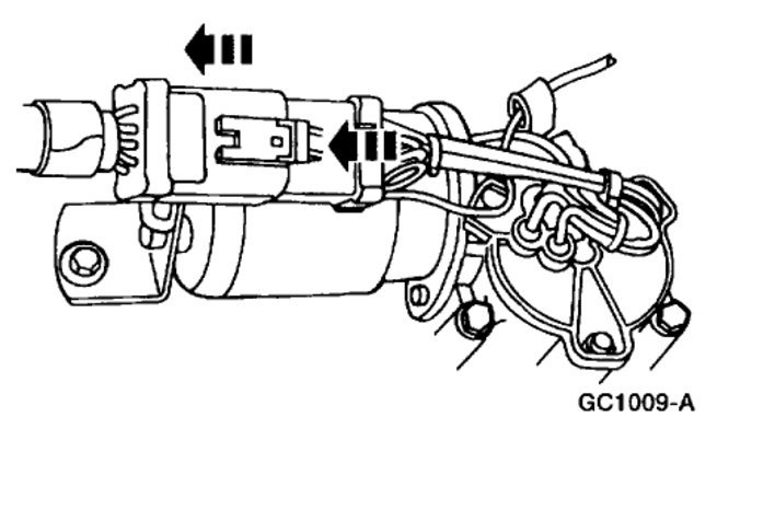

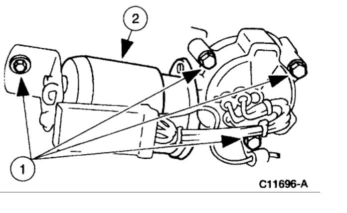

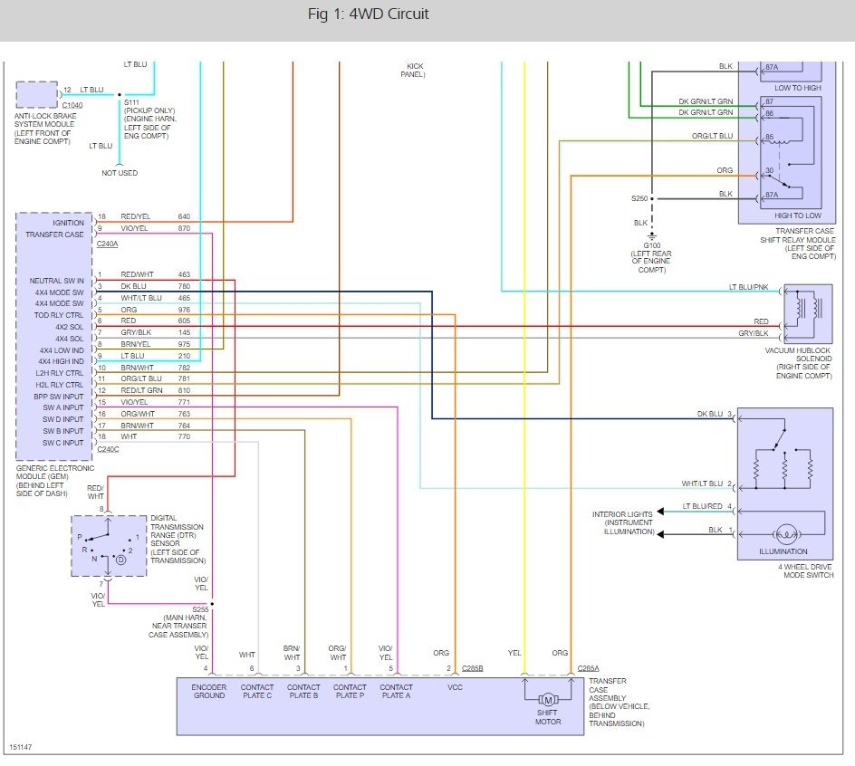

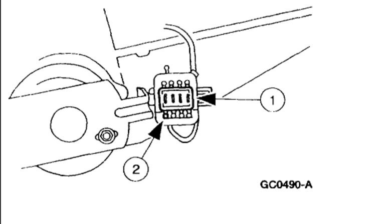

  • CAR REPAIR CONTRIBUTOR
  • 54,350 POSTS
When the four wheel drive stops working it usually is the fuse, relay or transfer case actuator. Here is some diagrams (below) and a couple for guides to help you test for the problem.
You can see from the wing diagrams the fuses and relays.
and
Here are wiring and fuse diagrams (below)
Please run some tests and get back to us so we can continue helping you.
