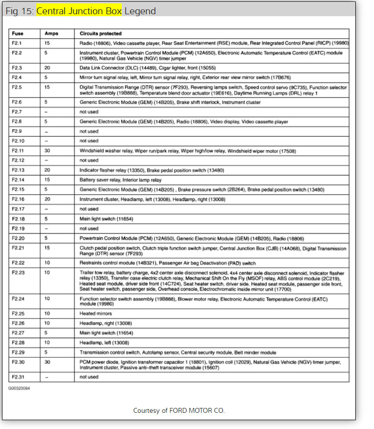

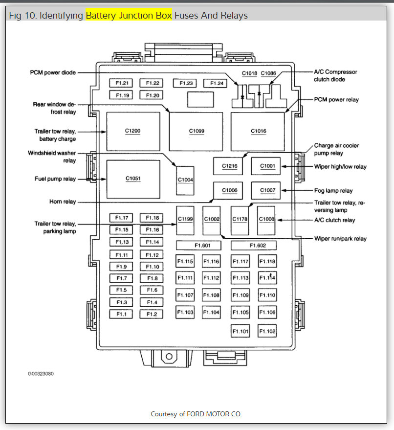

I was installing an LED light bar today when I accidentally touched the positive terminal on the battery while the wrench was on the ground screw. Now my gauge cluster is showing the e-brake light thesis light and the maintenance now light and the check engine light are on and the truck is running like it is missing.

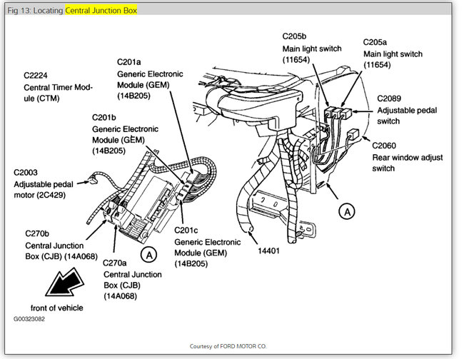

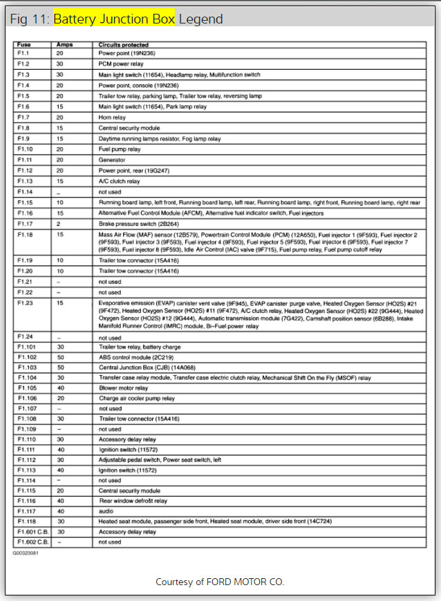

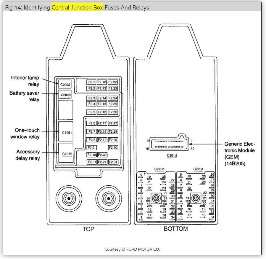

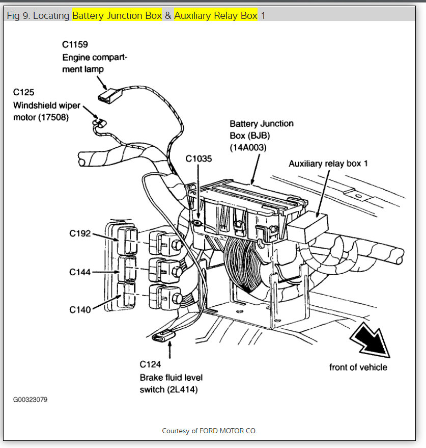

Start by checking all fuses here is a guide to help you see what you are in for
Here are the fuse panel locations and identifications
Also run the codes to see what comes up

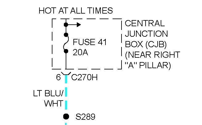

JDL
  • 16,098 POSTS
Pin 16 at the datalink connector, does it have voltage? Hot all the time.
Wednesday, September 9th, 2020 AT 5:31 PM (Merged)
GSLRIDER
I'll have to check. What should I read, 12volts?
JDL
  • 16,098 POSTS
Close to battery voltage.
GSLRIDER
Have to give me time to check it. What if I don't have voltage? Is the cpm bad or is it fused?
JDL
  • 16,098 POSTS
It's a fused circuit. Below
