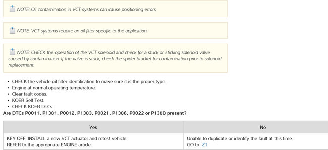

We all know these 5.4 liter Ford engines do not last, but I was hoping you could give me an idea what is going on. I am a mechanic and a pretty good at diagnosing, but the truck will run great one day then run like a diesel seconds later. 30,000 miles ago it had all new plugs and coils, along with new cam phasers. I have the codes p0011, p0012, p0300 -p0305, p0340, p0344, and p0345.
I cannot grasp why there are so many misfire codes, unless it is something internal like a VCT solenoid, timing chain, or CMP sensor. I really do not know where to start.

You are going in right direction see pic to check VCT actuators maybe the problem. There is a TSB for later model ford trucks for this, but shown is test and what to check. Then check fuel pressure for misfire if you still have them as well as doing freeze frame to read sensors to see if one low or out of spec. See picture.
