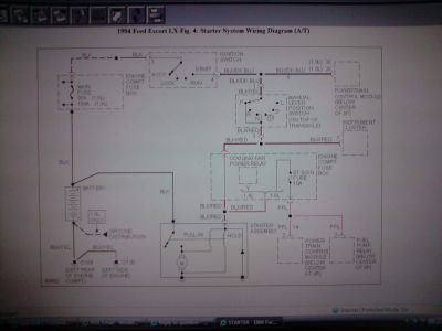

even with the ignition turned OFF, key out If i the battery is connected - the starter starts operating( tries to start the vehicle) I was told that there was a secondary Soleniod that is either stuck open or closed - could it be the ignition control modual ? Or is there really a secondary soleniod & where would it be @ ?

do the ignition light's go off when you remove the key ???
https://images.2carpros.com/forum/automotive_pictures/266999_P041208_1117_2.jpg
DESCRIPTION The starting system includes a 6-pole, 4-brush starting motor with solenoid-actuated drive, battery, starter/ignition switch, manual lever position sensor (A/T), clutch pedal position switch (M/T), starter relay (some models) and associated circuitry.

it had nothing to do with any lights - the car could be off, NO KEYS in it(they were in my pocket) & when u hooked up the battery, the starter would just start cranking - what it was was the wiring harness & the actual ignition switch had malfunctioned, & burnt out causing a cross-fire in the connections, i've wired in newer connectors & a new ignition switch & now it works perfect ----> but thanx
