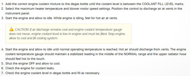

Had a garage replace transmission. Everything seemed okay until went to turn heat on. No heat. Took it back said my heater does not work. Service manager said, you need a heater core and it is going to cost a lot of money. I said my heat worked when I brought it here. I googled no heat before I came and it said there is probably air in the lines if you just had work done. He says we do not have the equipment to bleed the line and if there was air in them it should have worked out by now. Then he says we did not mess with or do anything to your heating system. Replacing the transmission does not effect it. He has on my bill $20.95 for antifreeze?

HMAC300
  • 48,601 POSTS
This is up to you as far as suing or just having another place or yourself bleed the air out. See picture on how to do it the degas bottle is the reservoir. If it still has no heat then pull hose that leads to radiator, fill that with antifreeze then fill coolant bottle to full mark then start car and let idle.

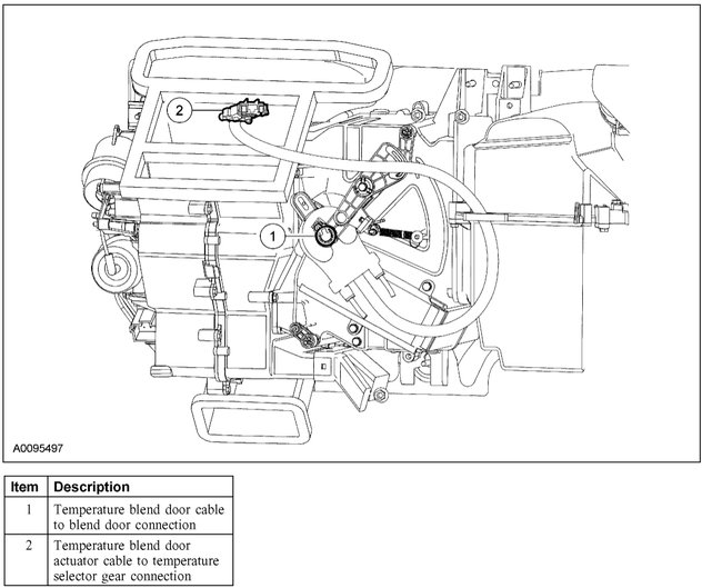

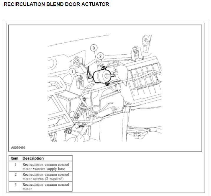

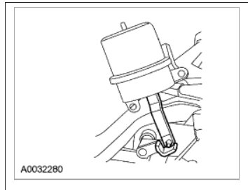

MFABBRI
  • 2006 FORD ESCAPE
Heater problem 6 cyl Four Wheel Drive Automatic 79,000 miles
I let the engine warm up to normal temperature and then I try to use the heating controls and I get cooled air then if I leave the controller in one of the heating positions after a period of time then I get a small amount of warm air, then it goes cold again. As the temperature outside rises then the air gets warm. The controller seems to stick in certain locations. I don't know if it is a vacuum problems or blender door. Any advice would be helpful.

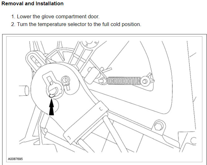

KEN L
  • MASTER CERTIFIED MECHANIC
  • 43,072 POSTS
It sounds like you have a low coolant problem or the termaturpe blend door actuator is going out and needs to be replaced. Here is a video to show you how to check the coolant level.
https://youtu.be/GSE9skKnOgY
Here is a guide to show you what you are in for when changing the temperature blend door actuator.
Here is a heater not working guide to help as well.
Here is the blend door actuator location for your car (below)
