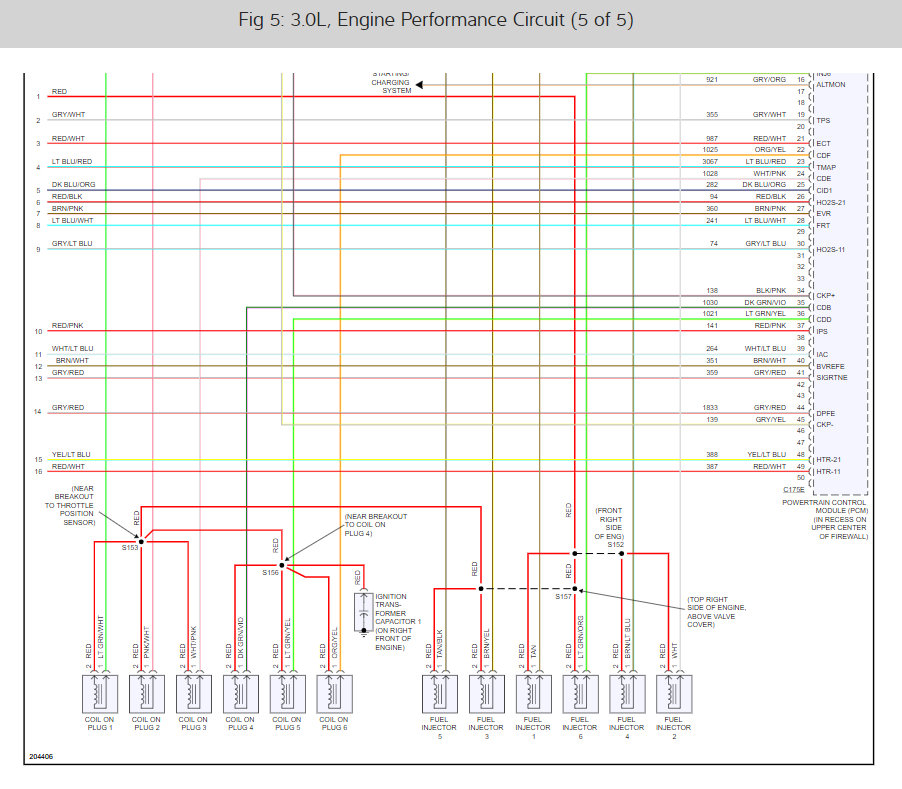

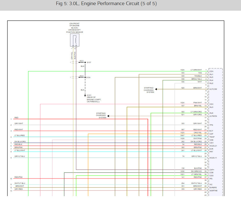

With key on (not running):
Test light connected negative battery terminal to solid red wire on coil connector = light on.
Test light connected to positive battery terminal to orange/yellow wire on coil connector = test light on . Ran the same test on coil # 5 = no light on light green/yellow wire .

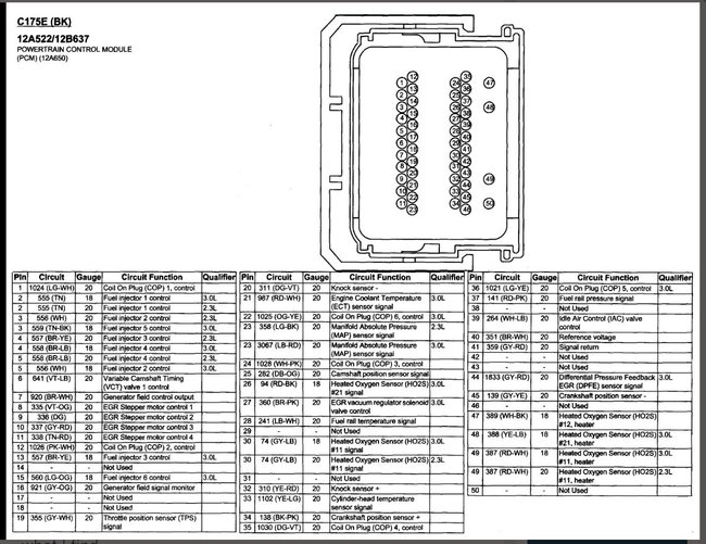

My PCM is a 3 connector type , I would appreciate some help with the proper wiring color/punch out diagram for isolating further this apparent short to ground.
Your assistance is greatly appreciated.
Sincerely, Ian

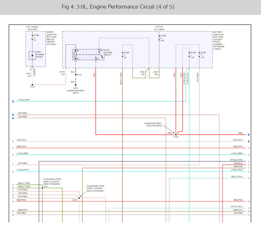

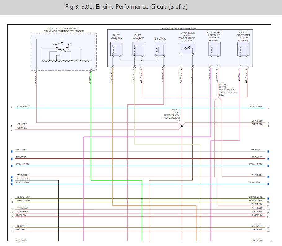

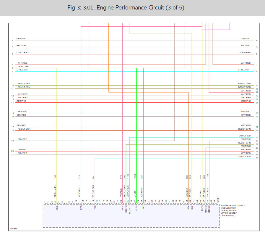

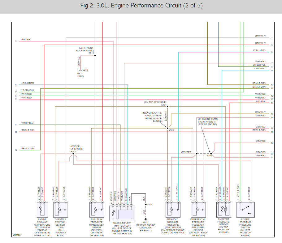

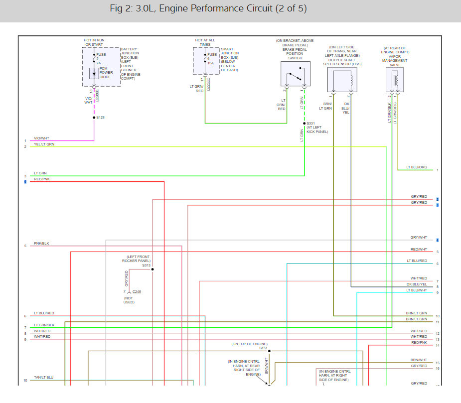

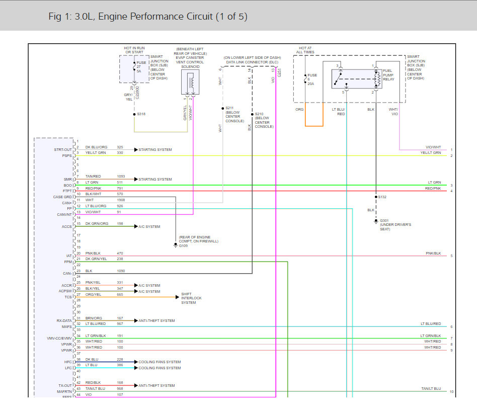

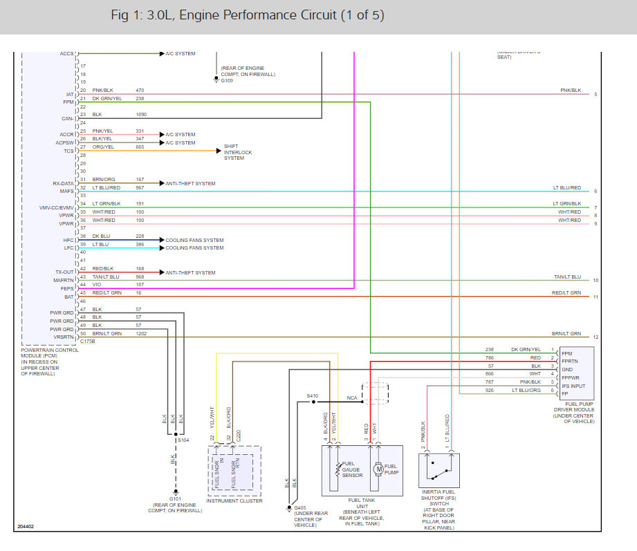

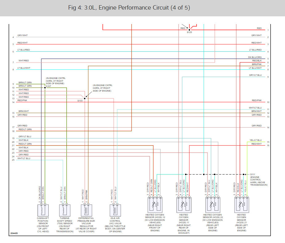

Here is a good guide on how to check the wiring with the engine wiring diagrams below so you can see how the system works and which injector wires to test:
Check out the diagrams (below). Please let us know what happens. Can you please shoot a quick video with your phone so we can see what's going on, that would be great. You can upload it here with your response.

Ken, thank you very much for the quick response and schematics . Although (diagrams 4 and 5) show this a single PCM connector, I needed the (Red coil wire diagram)(thank you for that ). Interesting during my research using 2carPros I found a previous thread for a 2005 Escape diagram. request providing the attached pinout on a 3 connector type PCM. (fyi attached ).
I did resolve my issue on #6coil / #22 pos. PCM. I ran a new wire: (in sep. loom spliced/soldered/heat shrink at both ends of connectors.) (i know not prof. protocol) but we are back up and running .
