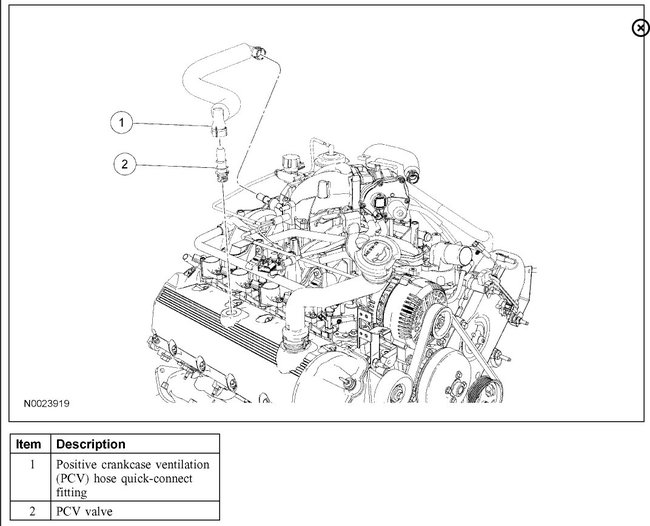

Where is the PCV valve located on the 2006 Ford E-150, 4.6 litre, van. Is it easily reachable and replaceable by the mechanically inclined backyard mechanic?

Your vehicle's heated positive crankcase ventilation (PCV) element is located at the top of right cylinder valve cover here is a diagram (BELOW)

THANX TO BLACKOP555 FOR THE ANSWER TO MY QUESTION BUT COULD YOU PLEASE GIVE ME THE LOCATION OF THE PCV VALVE- THANK YOU

Sorry about that, the pcv valve is on the valve cover. there will be a tube leaving itand going to the air cleaner box or the throttlebody/intake manifold.
