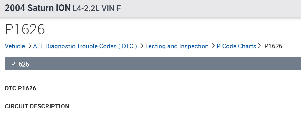

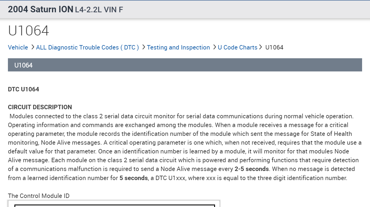

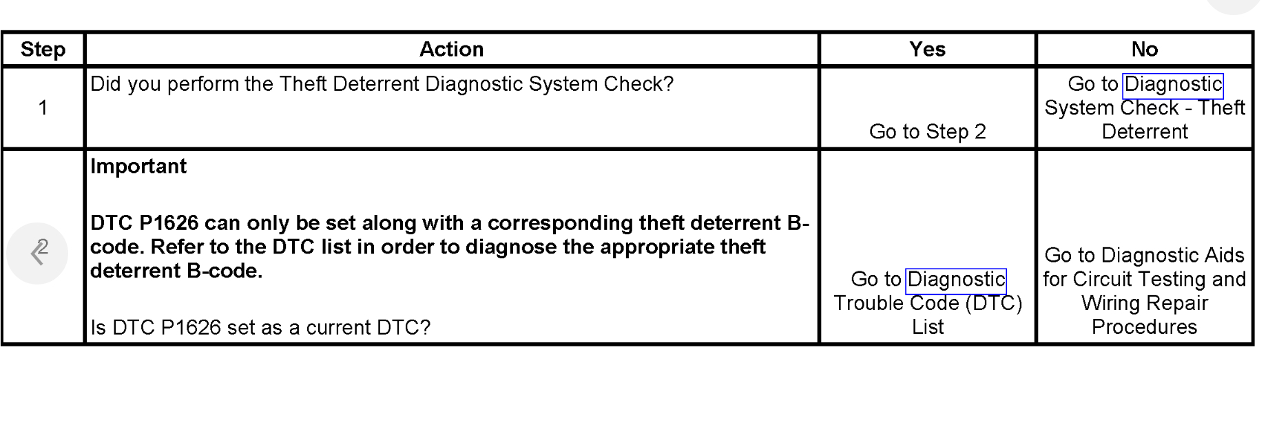

So my roommate drove her car through a deep puddle, came to the stop sign, rounded the corner and pulled into a gas station. When she went to start the car, nothing happened. It's showing codes P0520, U1064, P1626. Apparently it disables the starter. How do I get the electronics to work again?
What's my first step?

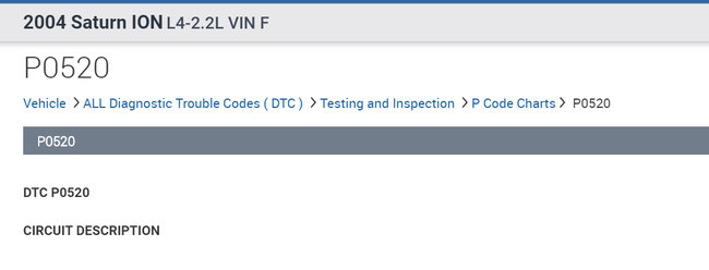

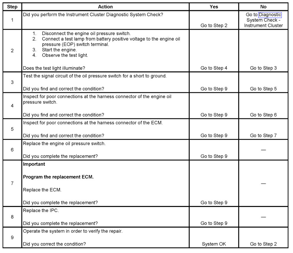

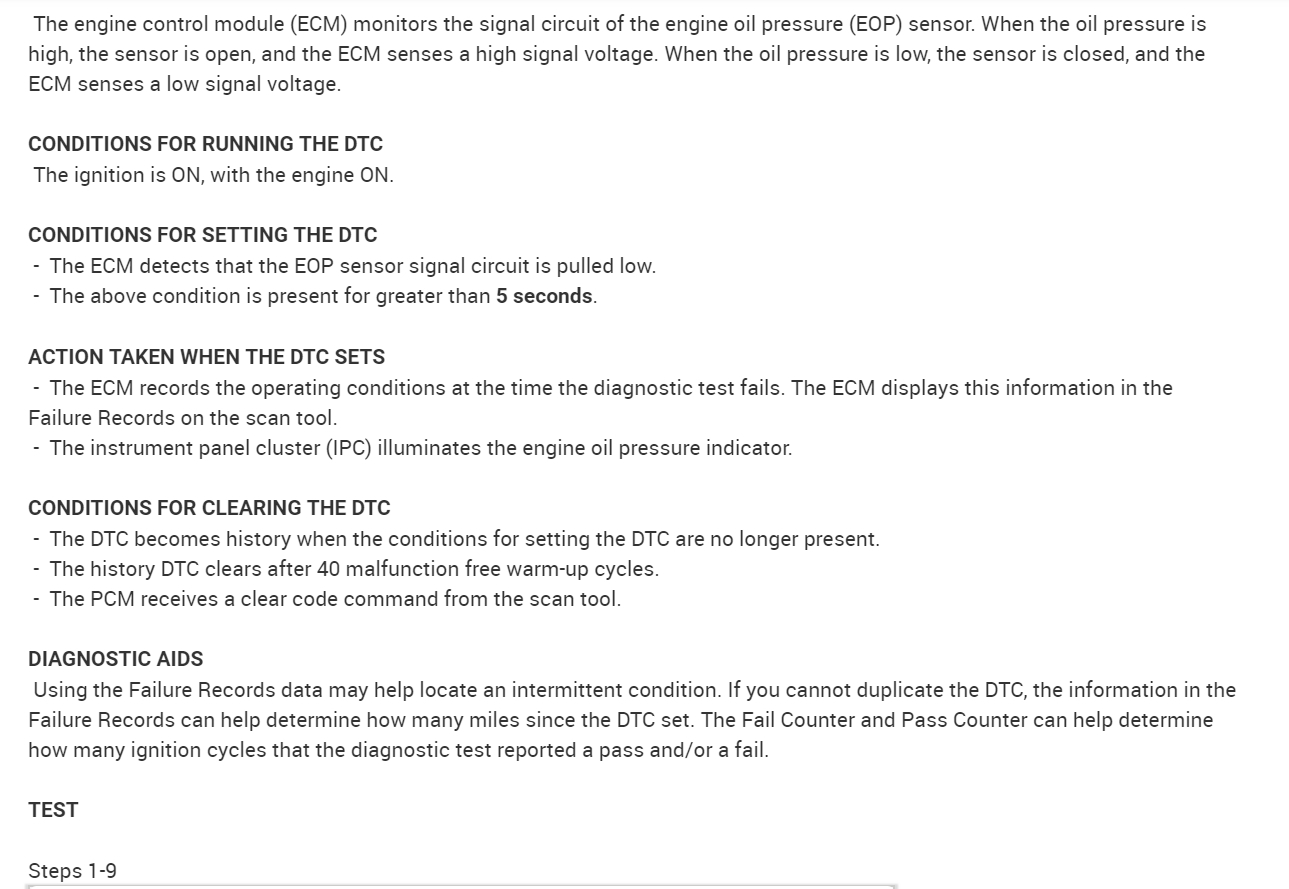

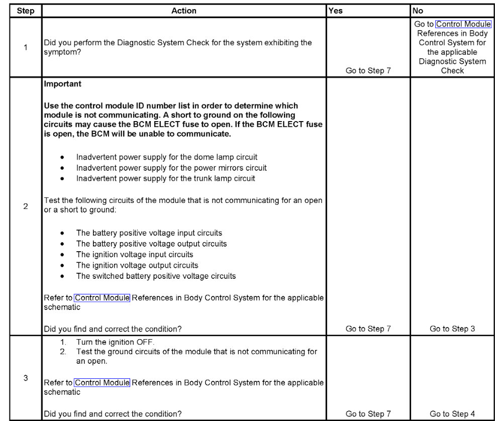

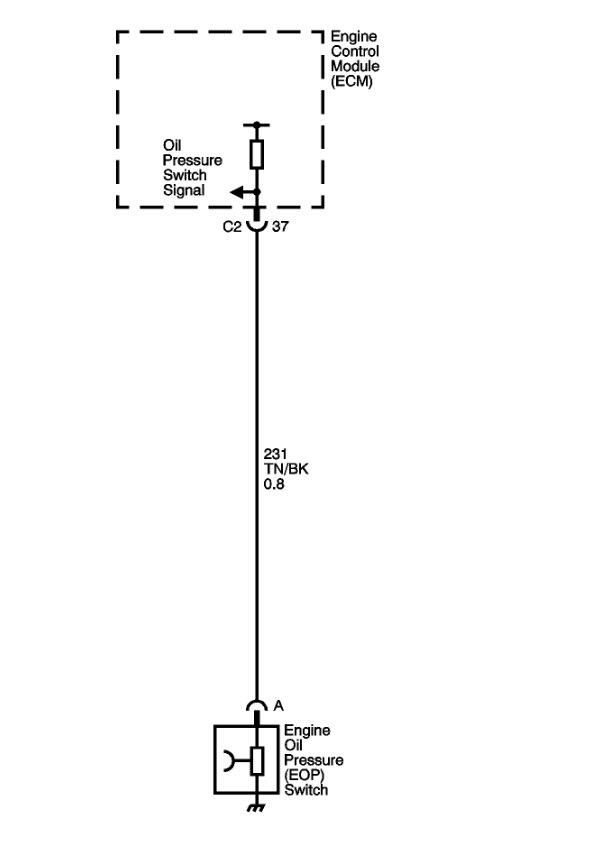

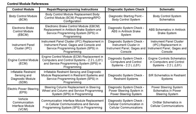

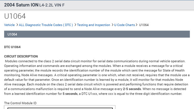

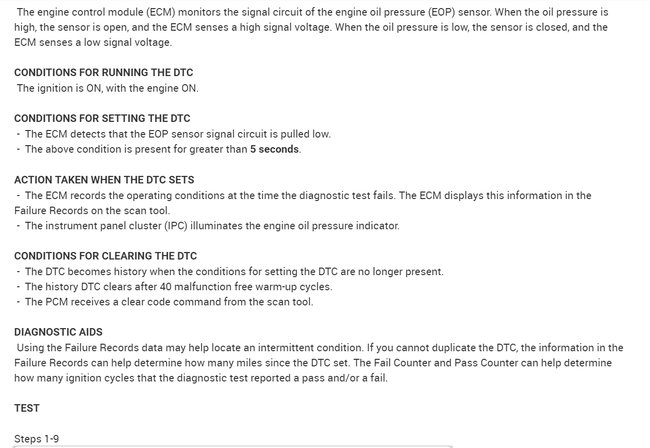

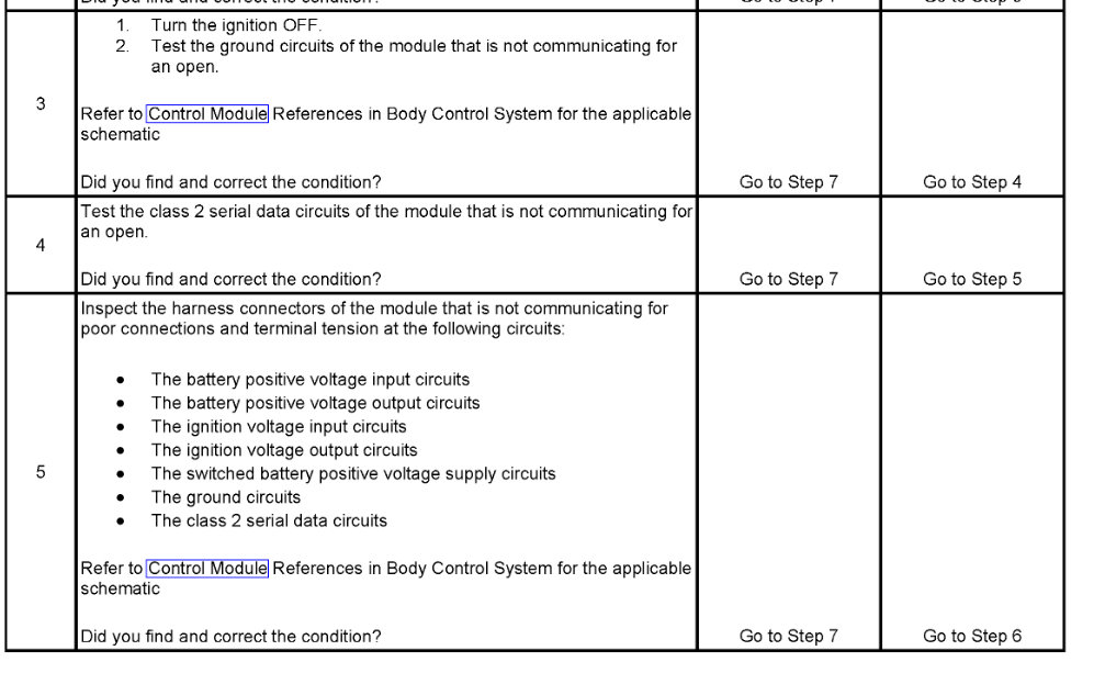

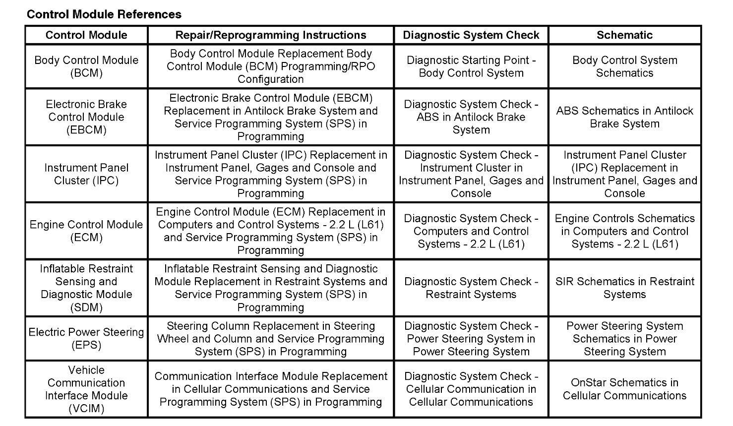

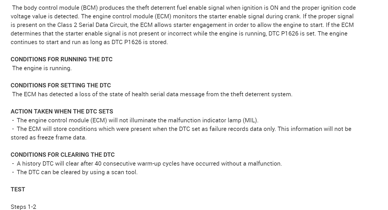

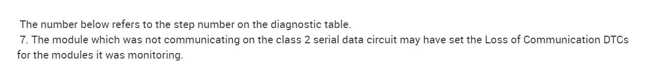

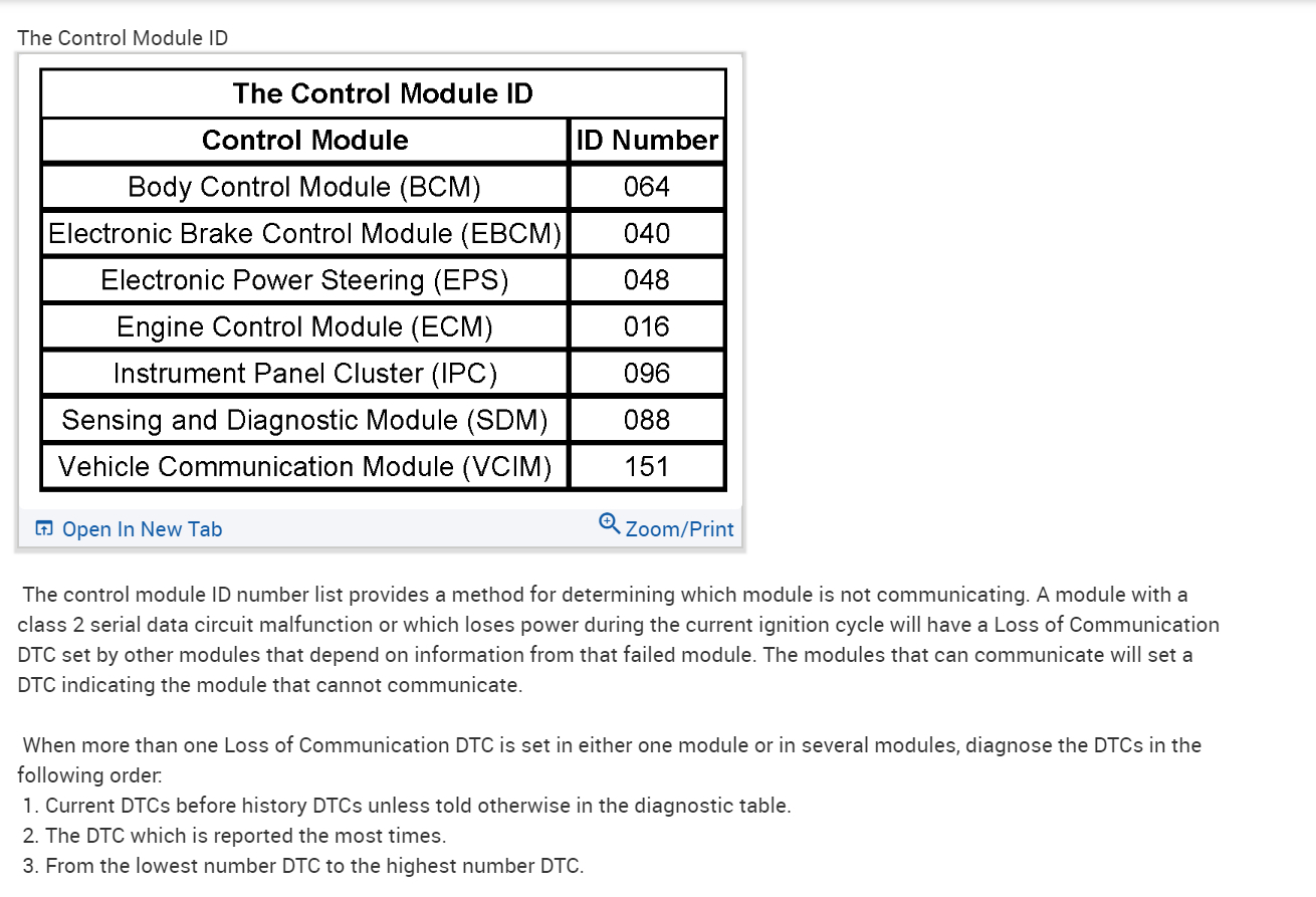

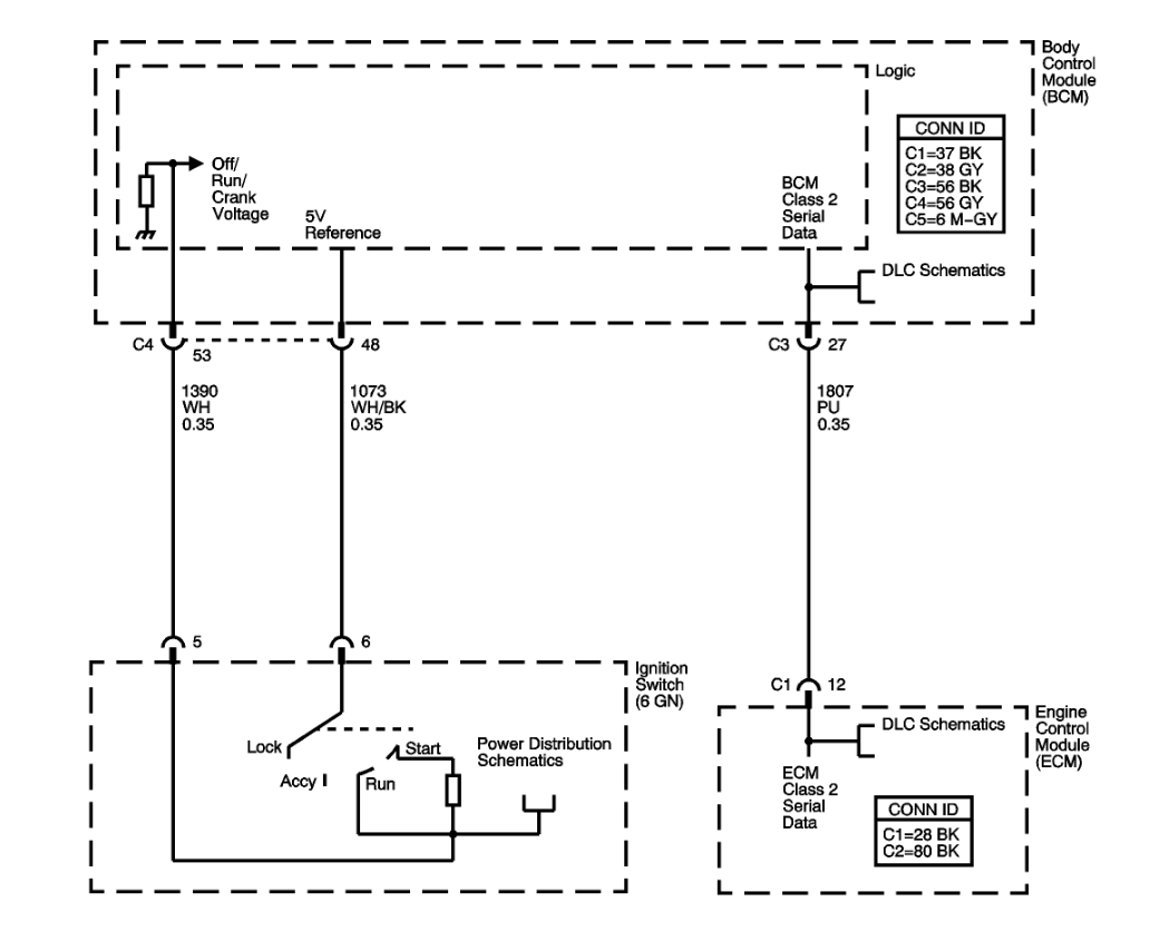

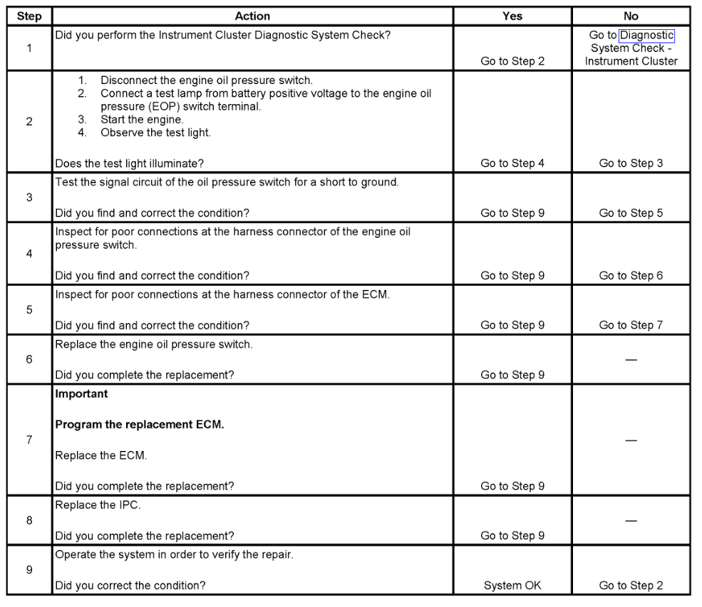

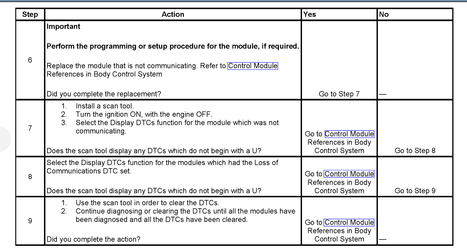

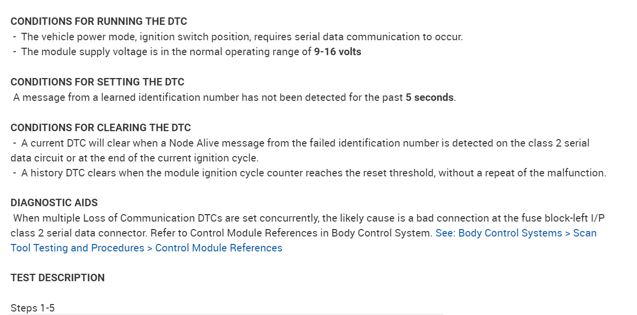

In the diagrams down below I have troubleshooting diagnostic flowcharts for all three of your vehicles Direct Trouble Codes (DTC's). Please go through them and get back to us with what you find out.
Thanks,
Alex
