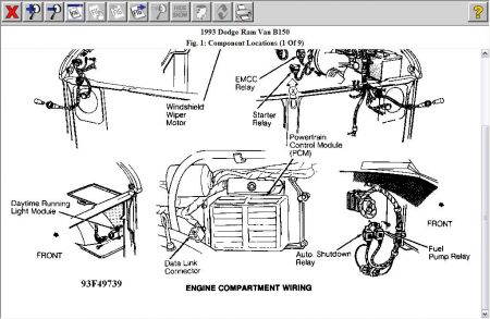

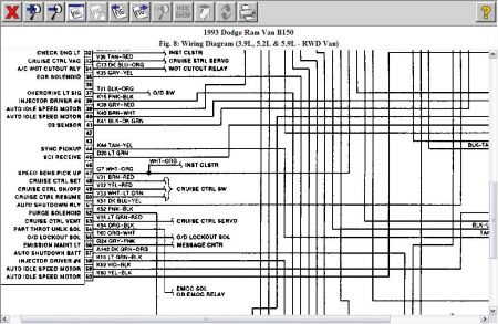

VABOO1
  • 1993 DODGE TRUCK
Cold start hard to start crank then clicking engine lites then fuel pump will come on and it will start replaced relay no help, no codes runs good when warm
