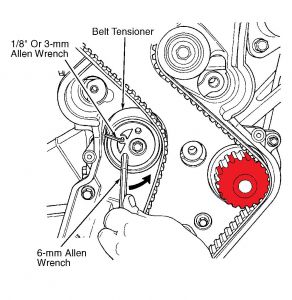

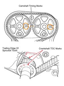

where is my water pump and how do I put a new one on what do I need to take off on the engi

Engine stay in
front right upper motor support need to be removed drive belt removed
drain coolant
remove timing cover and timing belt remove water pump bolts and remove water pump
