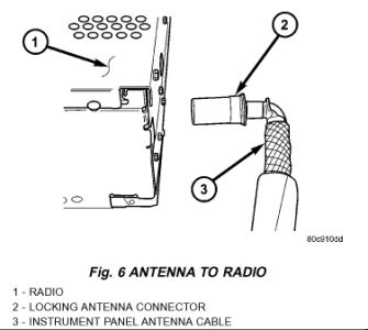

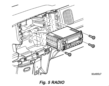

how do you take the stock radio out of a 2002 ram 1500

Hello - This information is for: 2002 Dodge Truck RAM 1500 4WD Pickup V8-4.7L VIN N REMOVAL Disconnect and isolate the battery negative cable. Remove center instrument panel bezel.
https://images.2carpros.com/forum/automotive_pictures/248015_1_35.gif
Remove radio mounting screws. Disconnect electrical harness connector.

Disconnect the antenna cable by pulling the locking antenna connector away from the radio (Fig.6) INSTALLATION Install antenna cable to radio. Connect electrical harness connector to radio. Install radio to instrument panel. Install instrument panel center bezel. Connect battery negative cable.
