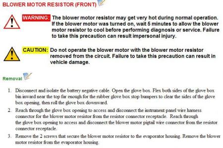

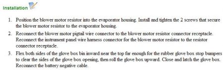

I just need to know the location of the front blower fan resistor.
