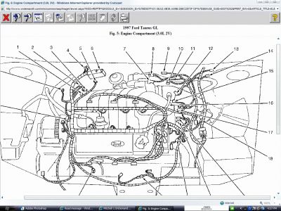

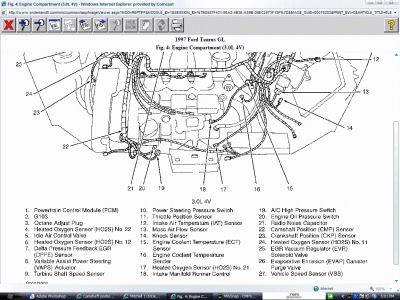

Yes we can help...however I need the engine size! There are two different ones! Year too...
Oct 21, 2007 at 3:39 PM
MERLIN2021
  • CAR REPAIR CONTRIBUTOR
  • 17,250 POSTS
Now that we have the info...look at #17!
https://images.2carpros.com/forum/automotive_pictures/62217_CMP97_1.jpg
https://images.2carpros.com/forum/automotive_pictures/62217_CMP97a_1.jpg
You need to check your VECI label under the hood, you still have 2 choices! 1 is a 3.0 4v the other 3.0 2v It should be on the label...The other is #22 This model requires the use of a syncronizer to install it, I will email the instructions...
