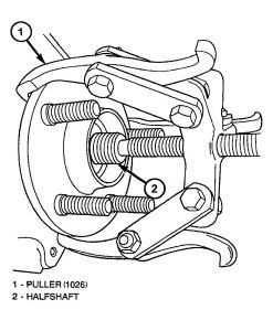

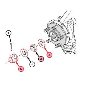

How do you change front wheel bearings?
Thursday, March 6th, 2008 AT 6:17 PM
BMRFIXIT
MECHANIC
19,053 POSTS
Require special tools !!!!
Raise and support the vehicle
remove tire
remove brake and rotor
remove pin and nut
then use special pulley
