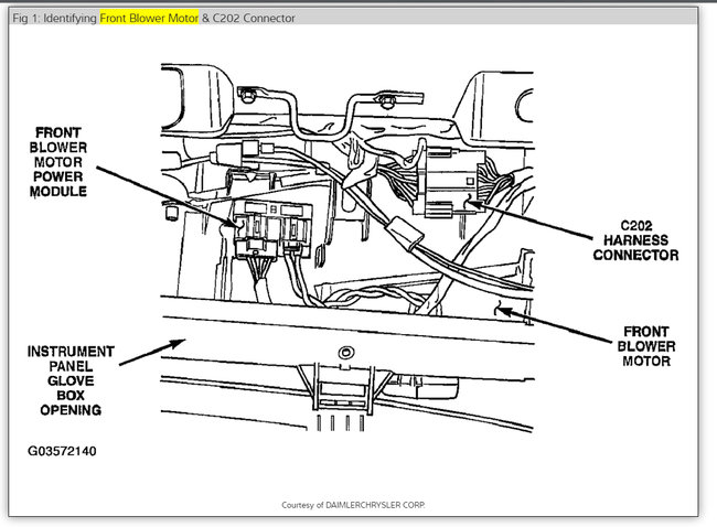

My pacifica 2004 american. With heater turn off the blower motor run at full speed and even on at fan lowest setting it still run on high fan could it be the control panel at fault
Sunday, December 17th, 2017 AT 12:58 PM (Merged)
KEN L
  • MASTER CERTIFIED MECHANIC
  • 43,074 POSTS
It sounds more like the speed control for the blower motor had gone out. Here is a diagrams to show you the location.

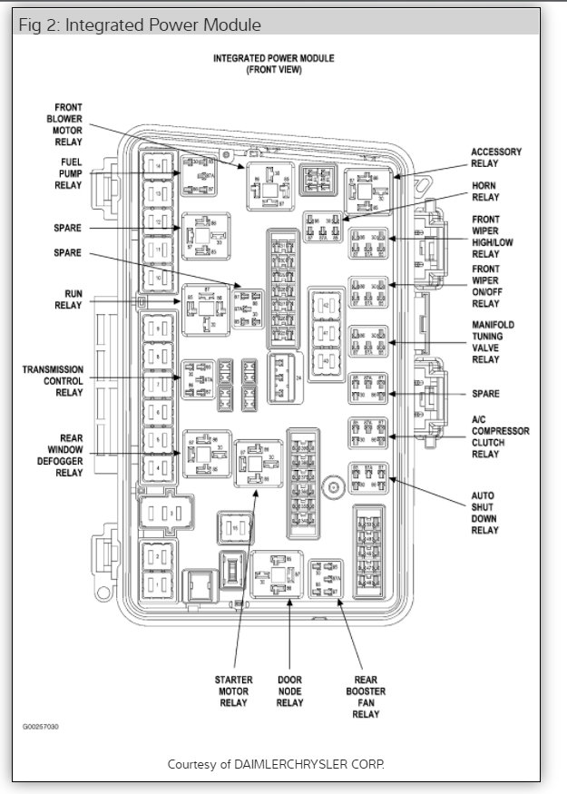

Front heater not blowing in 04 pacifica. Checked the fuses and relays. They are fine. Back heater blowing cold air.
  • 75,992 POSTS
Check and test fuse no.42 40amp, front blower motor relay and the front blower power module

My car heat has been acting crazy. First, I turn it on and it does nothing, then five mintues later it comes on. Then maybe it won't shut off. Sometimes the front blowers blow hot but the back seat blows cold. Sometimes it does not work at all. Other times the blowers up top for the defrost work fine but the blowers for the passengers does nothing. It basically seems to have a mind of its own. Any ideas?
Friday, February 8th, 2019 AT 7:57 PM (Merged)
  • 75,992 POSTS
Get the integrated power module tested
