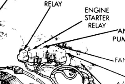

Makes a clicking noise before starting, what can I do

Hello, I'd make sure the battery has a full charge and the cables/wires are clean and tight on the ends.
The next thing would be to get at the starter relay, check the wiring circuits.
The location of relay, underhood, driver side fender well, in relay pack.
