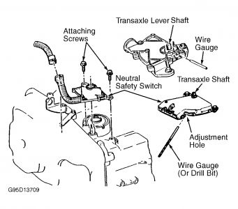

Is the neutral safety switch adustable and if so, how do you adjust it? Thanks.

Yes, your vehicle's Park Neutral Position (PNP) switch is adjustable. Follow the steps below to do so..
FIG. 16
