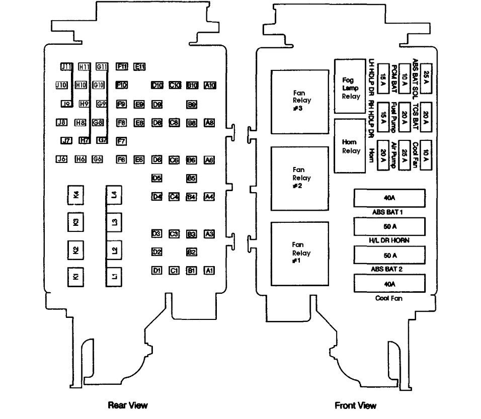

Not sure what the problem is not really enough info but the filter is directly under driver sides door dont be directly under the filter that when you start this guide can help with how to test the fuel pump relay and the location on the relay in the diagrams below.
https://www.2carpros.com/articles/how-to-change-a-fuel-filter
and
Fuel Pump Relay - In underhood electrical center No. 2. Check out the diagrams (Below). Please let us know what happens.

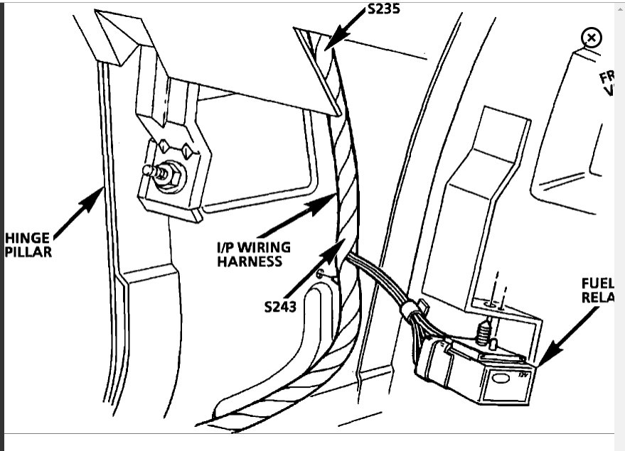

RAYMOND J
Fuel relay on 1994 Camaro Z28 is under the kick panel driver's side, square box on the floor by your left foot

KEN L
  • MASTER CERTIFIED MECHANIC
  • 43,110 POSTS
Here is a diagram of its location (below) and a guide to test it.

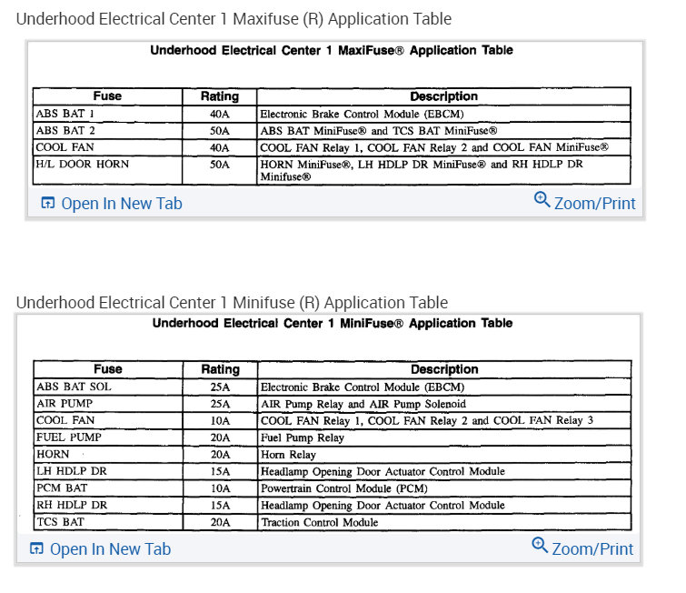

I have a 3.1(v6) 92 Camaro runs great until a few weeks ago. No fuel is getting to the injectors. First replaced fuel filter [maybe being clogged]. Then a new fuel pump relay. [No good]. So replaced the fuel pump. [ That was no fun.] But horribly the car still wont start! I now found out that the relay isn't getting any power ! Did a small test [giving the relay power straight from the battery ] and the car started and ran =). So I think it just doesn't have power. All my fuses are good and brand new computer. So if anyone could tell me where the relay gets it's power from. I would really be greatful
Wednesday, October 21st, 2020 AT 6:15 PM (Merged)
  • 75,992 POSTS
It gets its power from the fuel pump inline fuse 20amp orange wire.

JDL
  • 16,098 POSTS
Hello, there two sources of voltage for the fuel pump relay. Voltage for the load side of relay comes from an inline 20 amp fuse, maybe located under the hood, passenger side front, probably attached to the fender lining, you'll just have to look. The other source, for the coil side of relay comes from the pcm. This info also shows an oil pressure switch in the fuel pump circuit, once you crank it enough to bring up oil pressure, the switch closes and the pump gets voltage even without the relay. The o/p switch and load side of relay gets voltage from the same fuse already mentioned.
