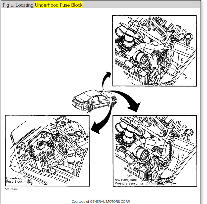

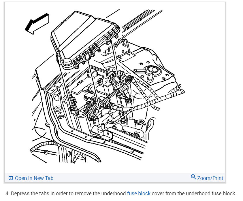

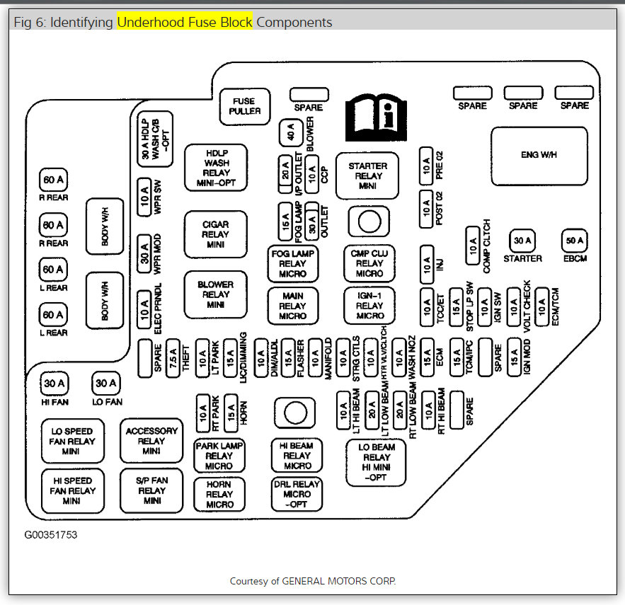

Check the connections at the battery, the positive battery cable, and the starter itself, for signs of thermal damage. If there is a burnt electrical smell, visually check the underhood fuse block/electrical center as it houses the starter relay. It is the same start schematic for either the 2.8/3.6 or the 6.0 CTS-V. The 6.0 is a little harder on starters due to the proximity to exhaust heat.

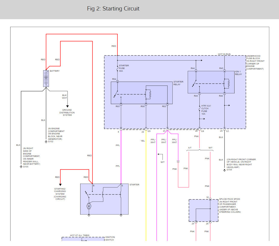

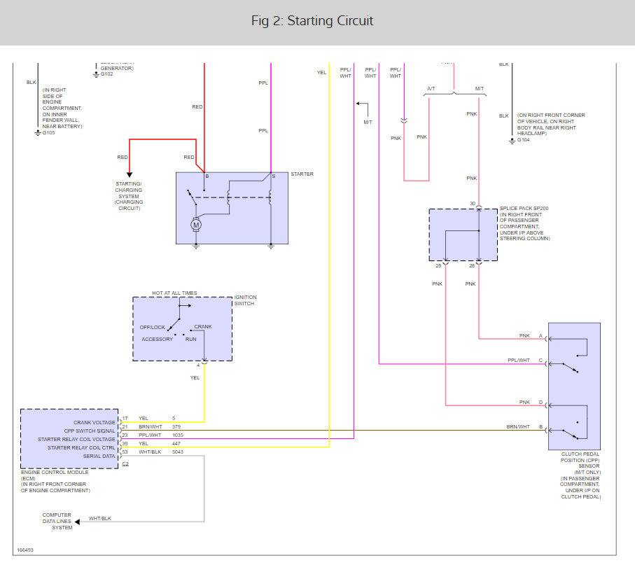

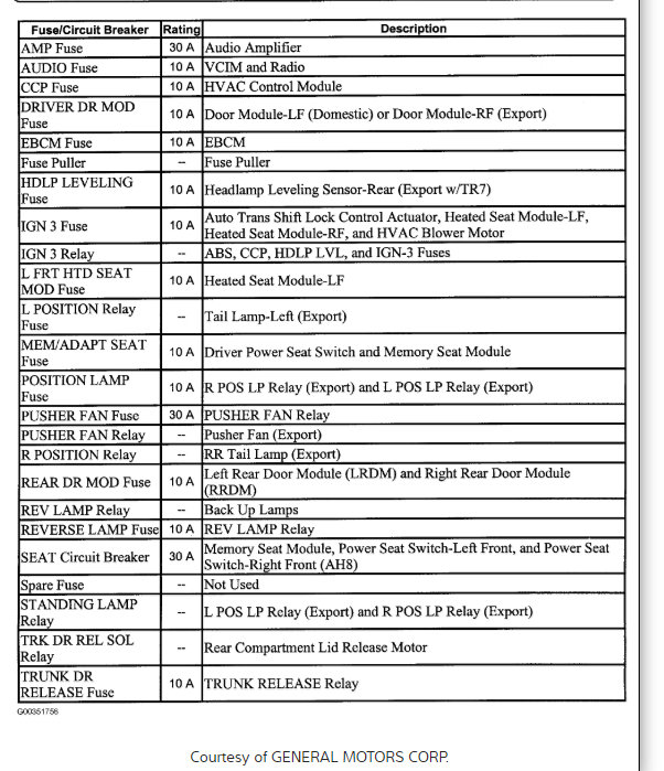

After I replaced the alternator, the car wouldn't star it would make a clicking sound.I finally got it to turn over, a few times then back to clicking sound. I had it towed to a mechanic, he changed the starter and it still won't turn over. Possible problem engine frozen? It didn't lose oil, didn't heat up, I feel there is an electrical problem. He is my local mechanic not the Cadillac dealer. Is it possible that the engine is frozen?
Saturday, June 20th, 2020 AT 10:52 AM (Merged)
  • 75,992 POSTS

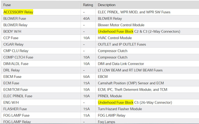

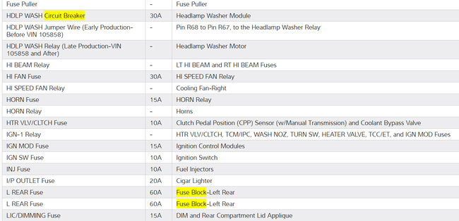

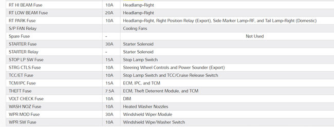

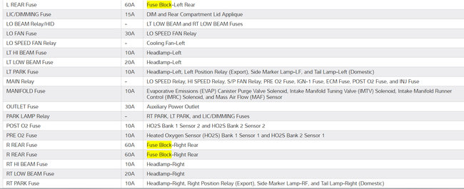

It sounds like you have a security light flashing or the starter relay is out. Here is a starter wiring diagram and a guide to help us see what's going on.
Here is the starter wiring and relay locations (below)
Check out the diagrams (Below). Please run some tests and get back to us.
Cheers
+9
SAMMIE SLICE
It won't crank over at all, just the clicking sound. When the starter won't engage it makes no sound so I checked the relay like you said and it was burn up, I replaced it and everything started working ya!
