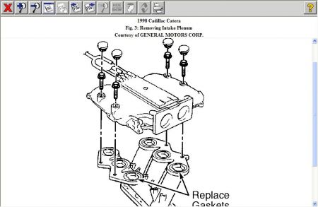

I cannot understand how to remove the intake manifold. I removed 4 bolts on the top but it does not budge.

I don't see anything holding it down pry hard till it budge and go around it with a screwdriver make sure you change the gasket-
