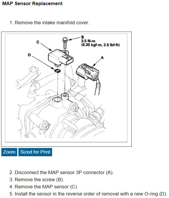

The check engine light on my car came on, and the codes were that three cylinders were misfiring. My husband replaced the spark plugs, coils and fuel injectors (not all at the same time, over a couple months when one did not solve the problem).
None of that has solved the problem. The car idles rough on startup, will sometimes smooth out and drive fine, but other times you can feel it "buck" or "thump" at a stop light and it hesitates on acceleration.
What else could be causing the problem? The check engine light is still on and it still gives the same codes.

This happens when the MAP sensor gets a little off but not enough to trigger a light. Here is a diagram below so you can perform the replacement.
Please check out this guide

Thanks you so much! I did this and it worked perfect for my car never ran better. I love this site. :)
