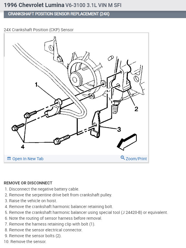

My 96 chevy lumina has been shutting off while driving. It mostly does it while you are idling down and then accelerating(while turning or coming to a stop). We took it to a mechanic. They cleaned out the EGR valve and now they have no idea what it could be.
