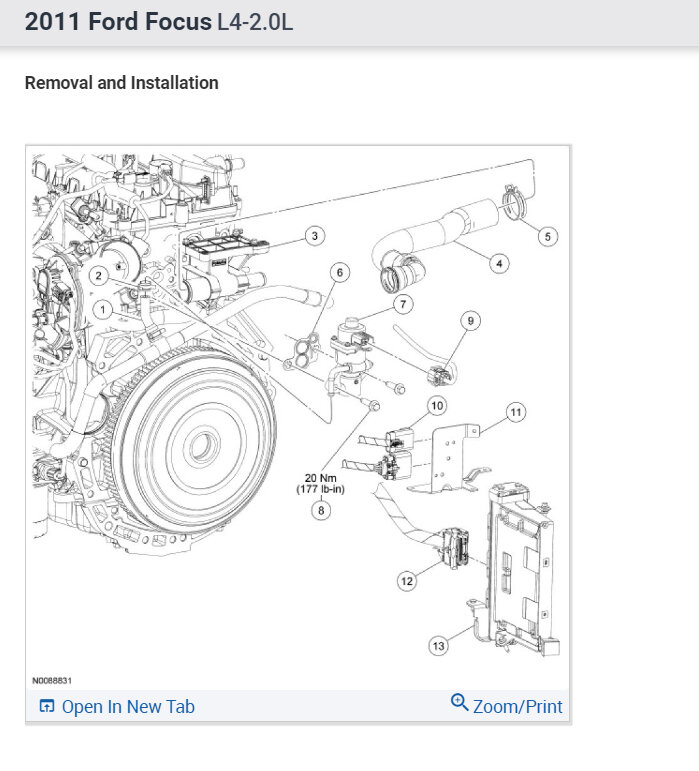

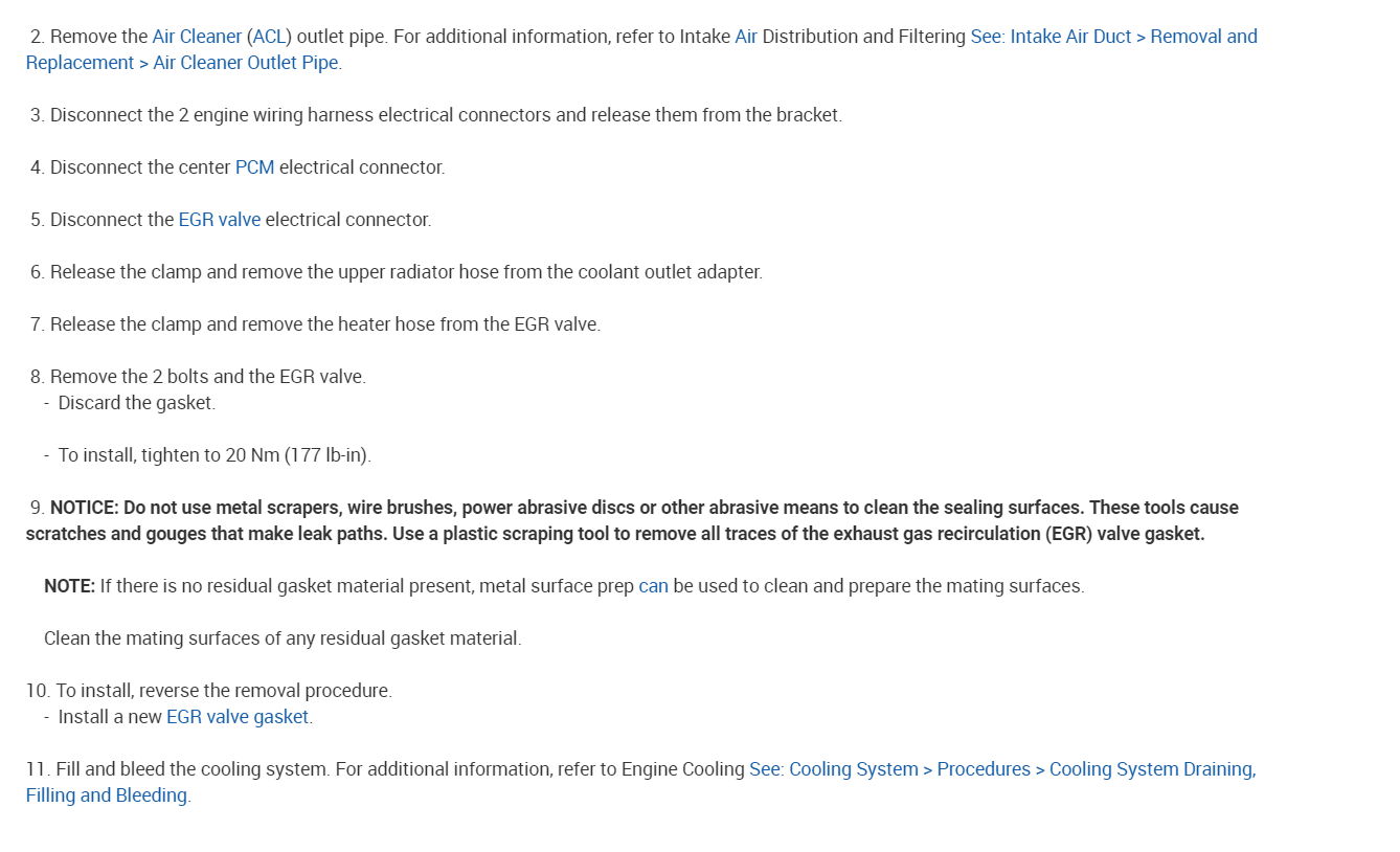

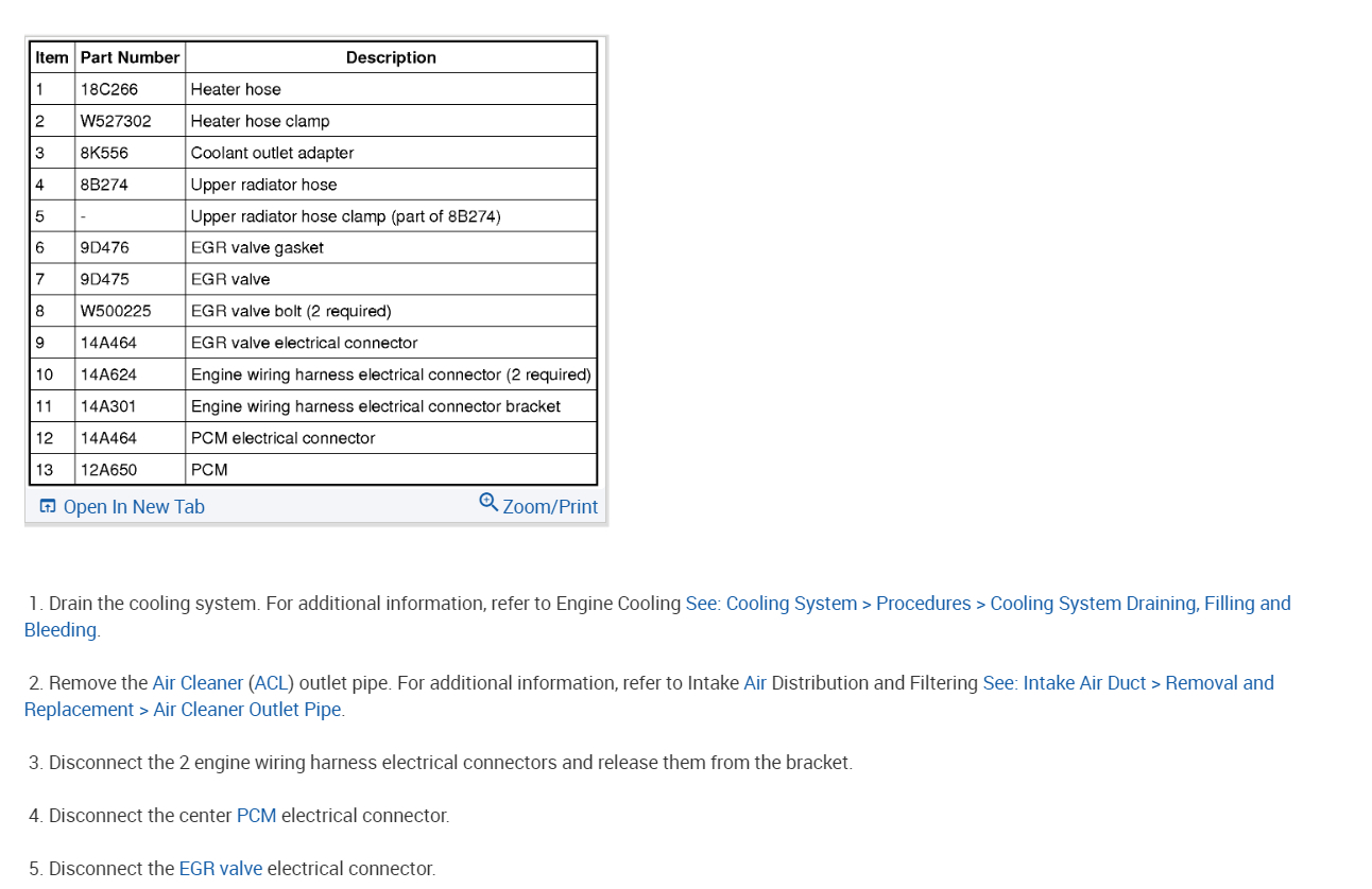

I have seen the EGR valve stick open and cause an internal vacuum leak. Here is a video to show you how to test it and the location of the valve in the images below so you can remove it for testing:
https://youtu.be/DqUCbbKdWf4
+2
