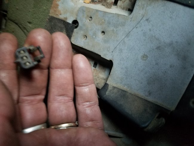

I had butter melt on dash and leak into wiring for ignition upon removal of dash found two plugs unplugged do not know what they go to and can not find where to reconnect them the butter mess had been cleaned and all wiring replaced to original location turn key in ignition motor tries to turn over but does not catch? Do not know what to do and there are no pictures of wiring under dash as if I am looking at the actual wiring set up so I'm dead in the water so to speak and need help.

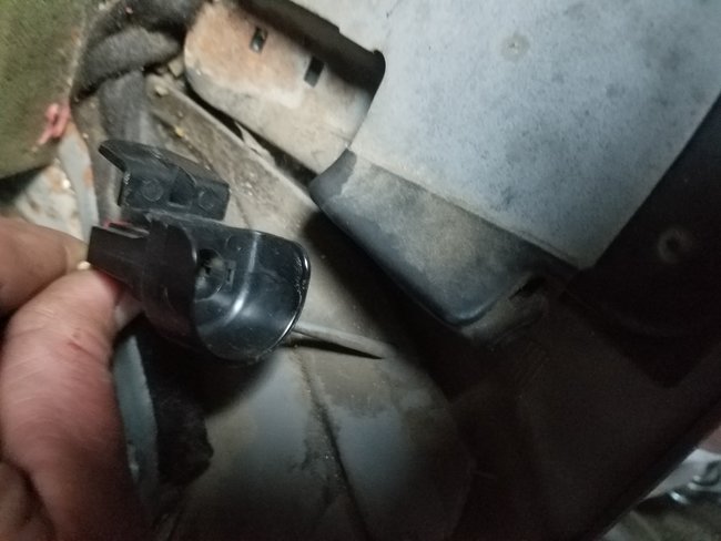

These are the 2 plugs could use a photo of where to plug them maybe

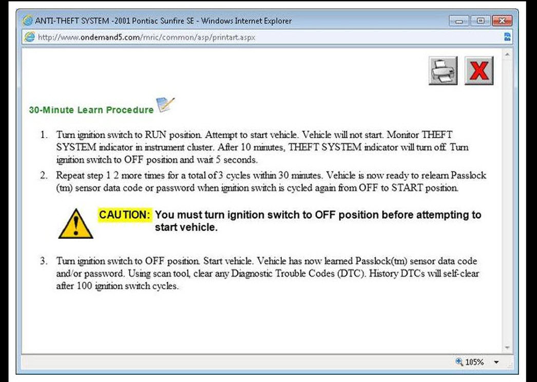

First pic look like a bulb holder for under dash, try a security system reset it may have set it off, 2nd pic may be for something you never had and was just there. What color are wires. See pic for reset.
Tuesday, March 28th, 2017 AT 9:32 AM
TAMARA SMITH2
The first set of wires is orange and white and the second is orange gray and and a off blue
Tuesday, March 28th, 2017 AT 10:35 AM
HMAC300
  • 48,601 POSTS
The orange white is an interior bulb that shold go under dash and a bulb plug in to it. I can't see anything for the three way connector so if everything works don't worry about it. It may be something that never came with the truck
