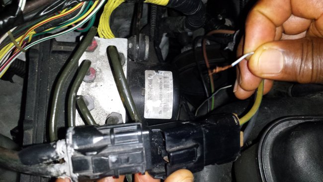

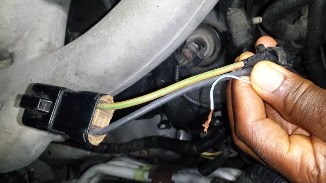

Good evening, it was discovered that the wire that runs from the fan to the connector is damaged. We would like to know where the little white and blue wire connects to. Can you please send a schematic wiring diagram showing where the wire connect to please, if you can? Please see images of wire below. Thank you in advance guys!

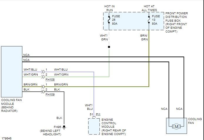

The White/Blue wire runs from the fan module behind the radiator to the ECU located at the rear of the engine compartment. I have attached a schematic showing this.

Before you sent this information. I tried connecting the little white and blue wire to another wire somewhere as result the fan works but it doesn't chip out.
Friday, February 1st, 2019 AT 1:03 PM
  • 110,194 POSTS
Not knowing what you attached it to makes it hard. However, it must have been direct to the fan. Does that sound correct?
+1
Friday, February 1st, 2019 AT 3:34 PM
AUSTINO
  • 220 POSTS
Good morning, yes the wire was directed to the fan, you are correct.
Saturday, February 2nd, 2019 AT 4:19 AM
  • 110,194 POSTS
Okay, then what I think you did was bypass the ECM and took power right from the fan module.
