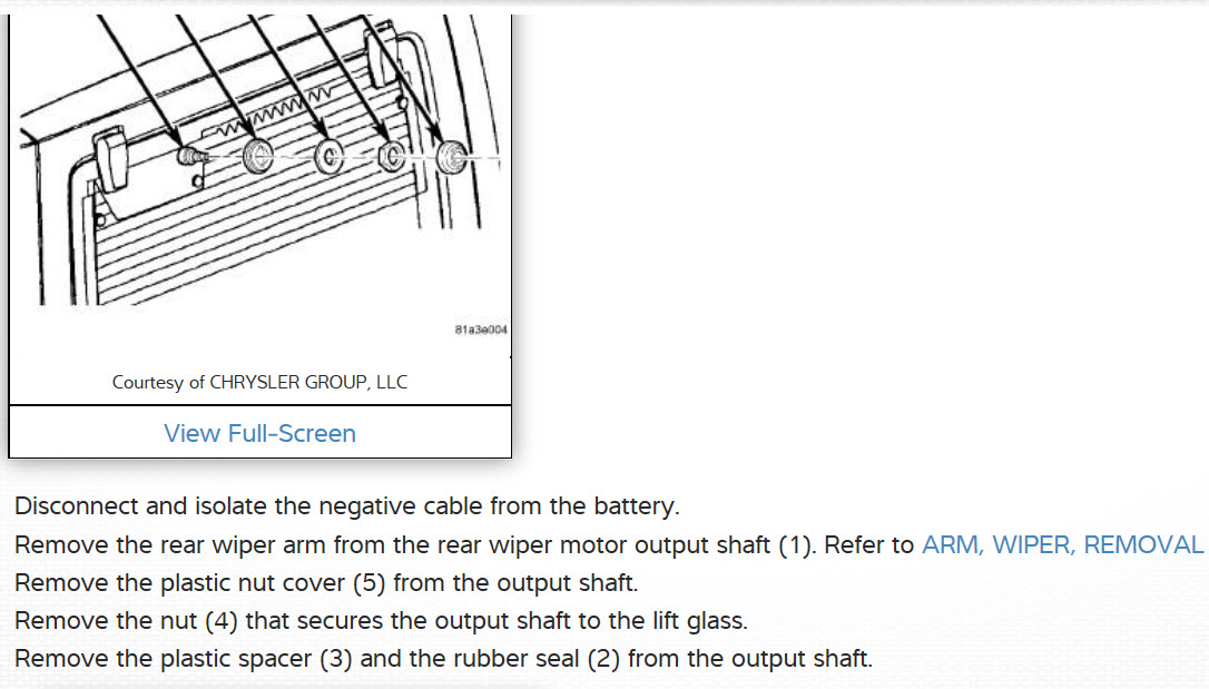

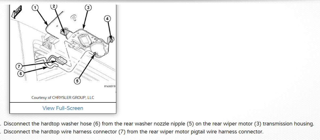

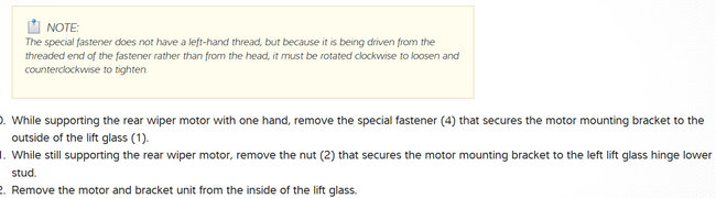

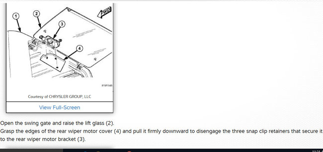

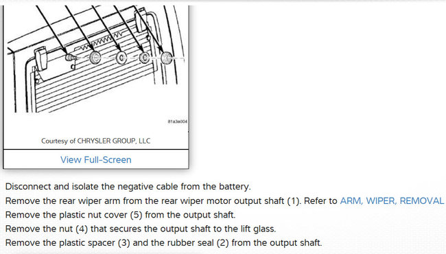

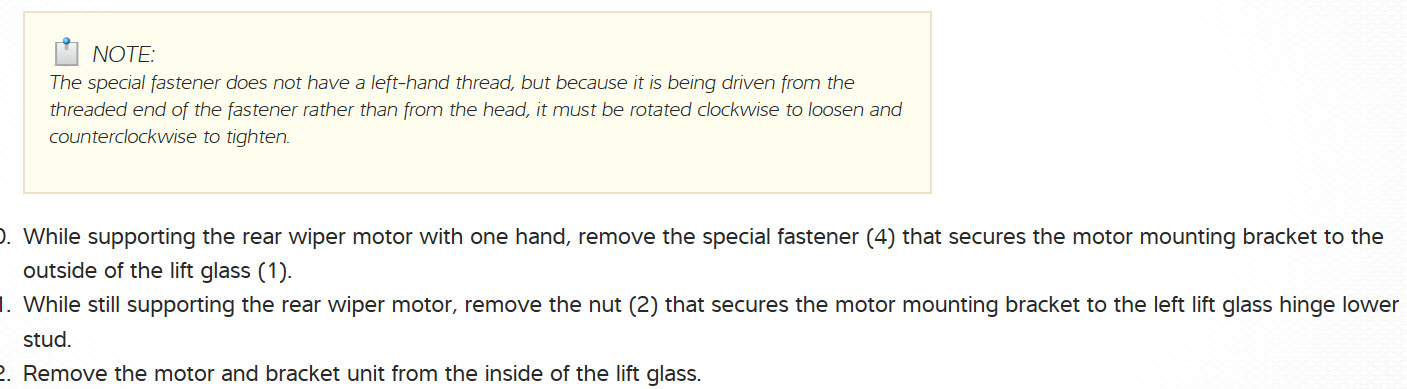

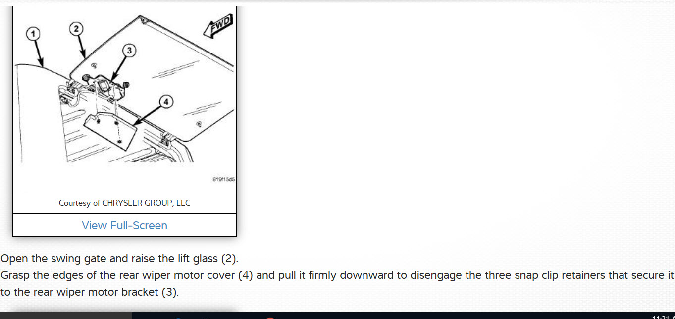

How can I replace my rear windshield wipers?
Tuesday, February 28th, 2017 AT 4:54 AM
HMAC300
MECHANIC
48,601 POSTS
If it does not work check fuses under hood and in car. If blade needs replacing go to auto parts they do for free. If motor does not work have a mechanic scan for codes because it may be something else. Other wise see pictures.
