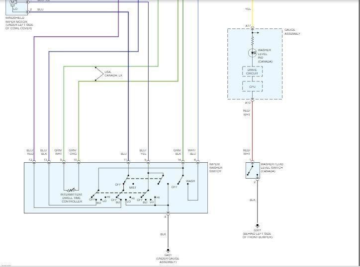

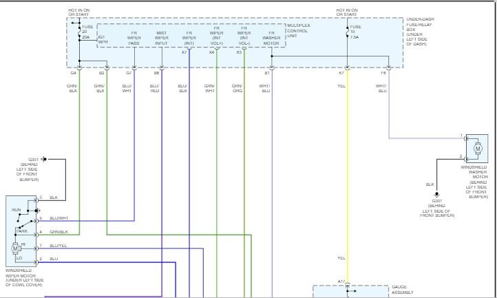

First, if the fuse only blows when you use the washer, I need you to check the white/blue wire to the washer pump. Check to see if there is a short to ground. Basically, with everything off, see if there is continuity between the wire and ground.
If the fuse blows when you use the wipers, that is a different issue. The two circuits are separate other than they function from the same switch. I will need to know which fuse is blowing. Also, just for the heck of it, disconnect the washer pump and then pull the washer lever back and see if the fuse still blows. If it does not, you may have a short in the washer motor. Do the same with the wiper motor if it is still blowing fuses.
I have attached a schematic of the system for you to follow (if needed). I had to break it into two pictures because of size. Otherwise, you would not be able to read it.
Let me know what you find and what happens when things are disconnected. Note: Only disconnect one thing at a time so you can eliminate one thing rather than question both. Also, confirm for me that it is fuse 20 (20 amp) in the under dash fuse box that is blowing.
One last thing, let me know if you removed the new switch and checked the connectors for bent pins, wires pinched, or any problems with the plug.

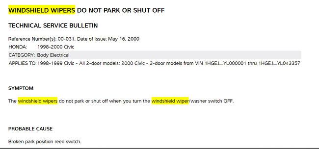

So I had my wipers on, I shut them off turned off the car and when I came back out and turned on the car and went to use the wipers they wouldn't come on. I took it to a garage it wasn't the fuse, and it wasn't the switch. When I put a fuse in they come on and work and I have to take it out to shut them off. Please help?

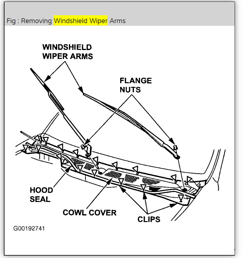

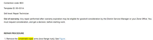

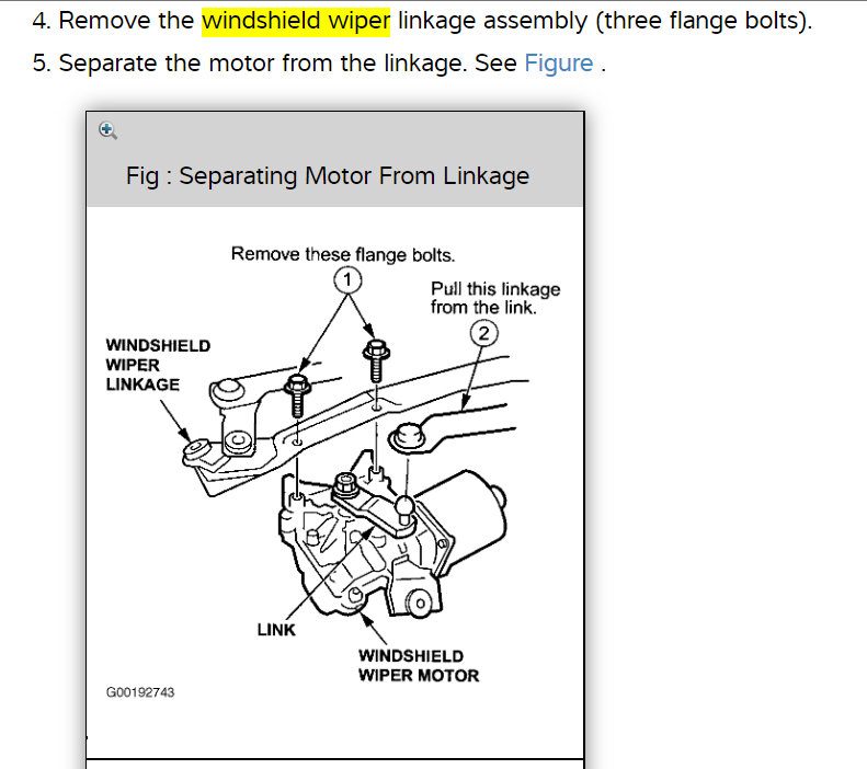

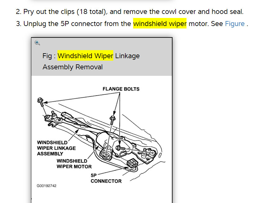

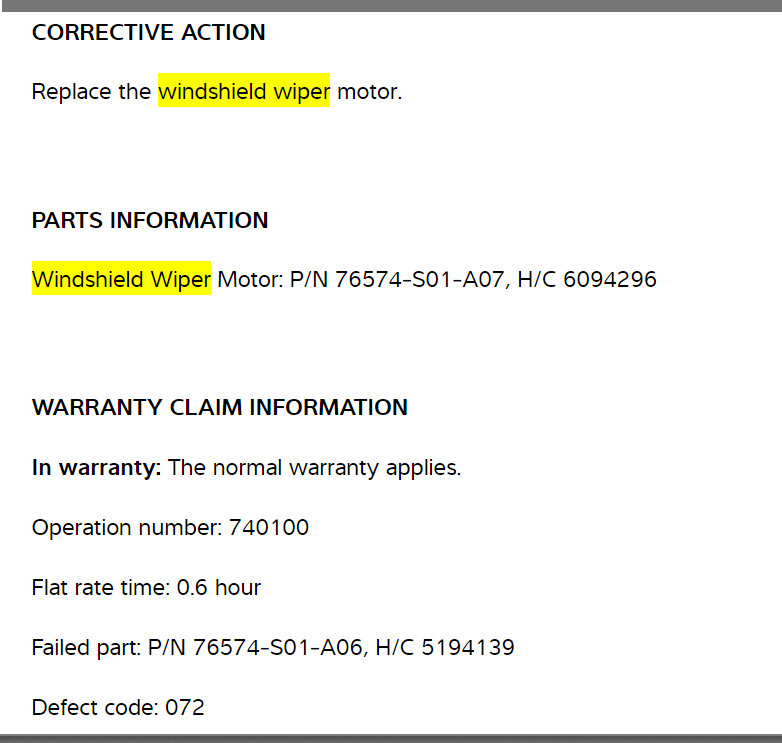

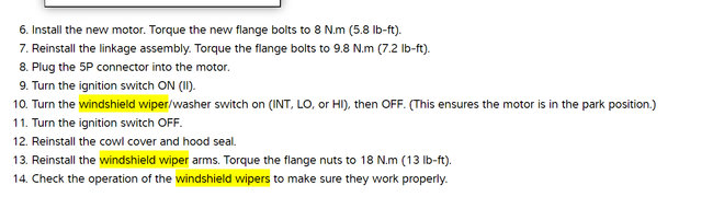

This sounds to me like you have a short to power in the circuit somewhere. But before we get into what it is going to take to fix it, I want you to take a look at this Technical Service Bulletin that I came across when I was pulling up your vehicle's wiring diagrams. I have included it in the diagrams down below. Please call your local dealership and inquire about it and then get back to us with what you find out. If not we can go from there and get it fixed ourselves.

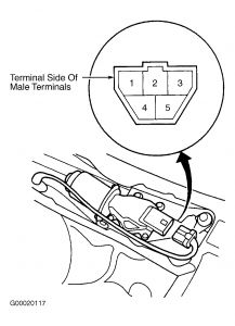

https://www.2carpros.com/forum/automotive_pictures/62217_civic_2.jpg
FRONT WIPER MOTOR TEST 1. Open hood. Remove wiper arms. Disconnect front wiper motor 5-pin connector. Using jumper wires, apply battery voltage to wiper motor terminal No. 4 (Green/Black wire) and ground terminal No. 2 (Blue wire). Ensure wiper motor operates on low speed. See Fig. 11 . Go to next step. 2. Using jumper wires, apply battery voltage to motor terminal No. 4 (Green/Black wire) and ground terminal No. 1 (Blue/Yellow wire). Wiper motor should operate on high speed. Replace wiper motor if it fails to run smoothly. See Fig. 11 . If wiper motor operates as specified, go to next step. 3. Connect analog voltmeter positive lead to terminal No. 5 (Blue/White wire), and negative lead to terminal No. 3 (Black wire). With wiper motor running at low or high speed, voltage should pulse between zero volts and 5 or more volts. Replace wiper motor if voltage does not pulse as specified. Fig. 11: Identifying Front Wiper Motor Connector Terminals (Civic Shown; Others Similar) Courtesy of AMERICAN HONDA MOTOR CO., INC. Page 1 of 1 WIPER/WASHER SYSTEMS -2000 Honda Civic DX 1/31/2009
