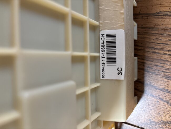

They are not manufactured anymore. So, I have to try to go to a junkyard and find a compatible GEM mod for my 2004 Mercury Sable LS premium. Do you know what cars are compatible with the swap? I have power locks power windows sunroof so forth anti-theft my VIN number is. 1MEFM55S84A621815 in my research it says 2004 2005 say all LS or Taurus will fit.

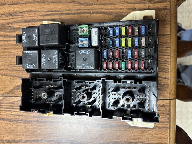

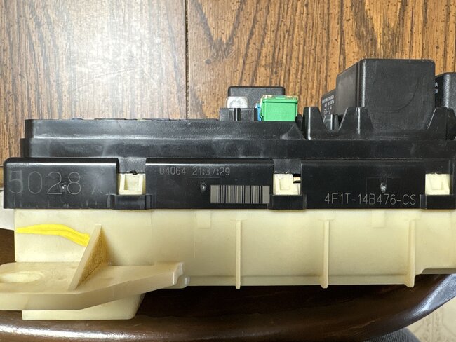

That is what I took out of the sable I have.

Yep, that is it, here are the cars you that should fit your car:
2004-2005 Mercury Sable LS models (sedan or wagon, with similar options)
2004-2005 Ford Taurus SEL models (particularly ones with sunroof, anti-theft, power locks/windows)
Let us know how it goes.
