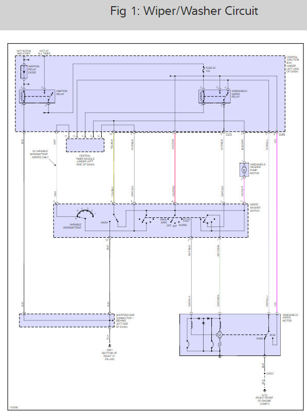

Weather below freezing pump stopped working. Is there a fuse?

Hello, sorry to hear. Since it is below freezing the fluid may actually be frozen. Have you checked that? The fuse is fuse 20, picture attached.

Thank you, very helpful. I did notice ice in the bottle in the trunk that I just bought.

They do make various fluids that may help to resist freezing.
