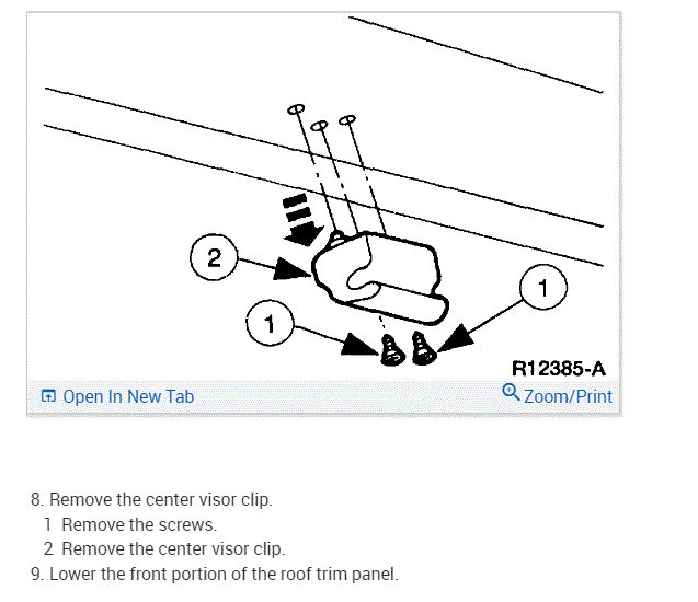

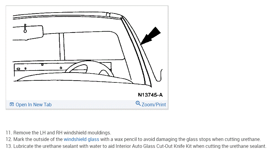

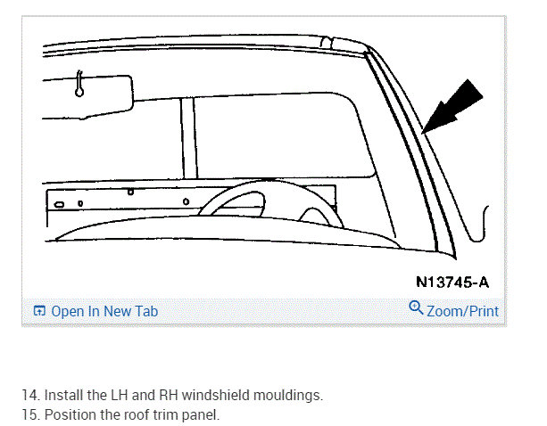

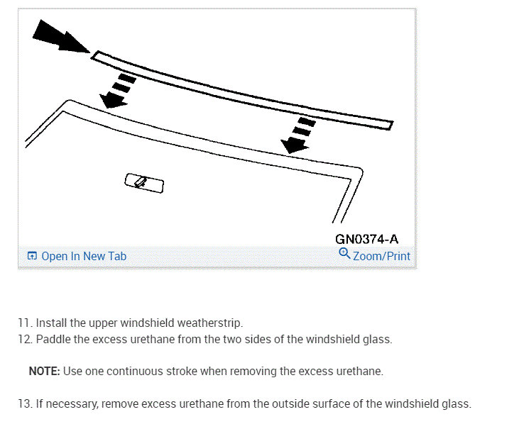

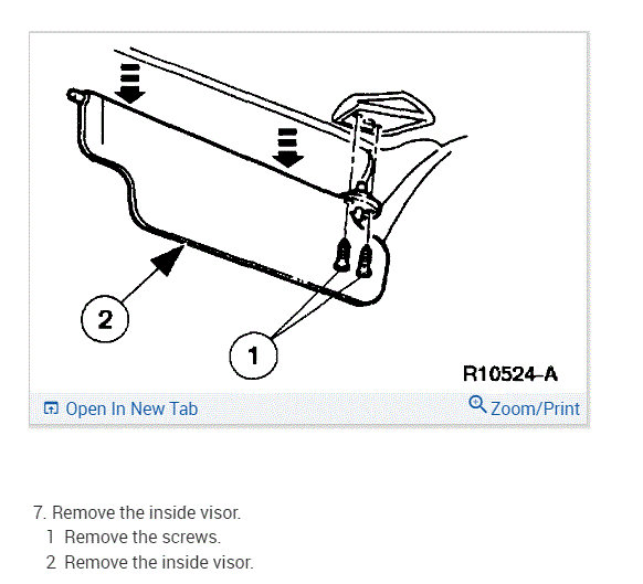

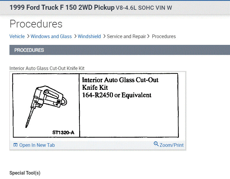

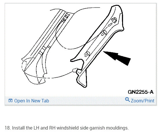

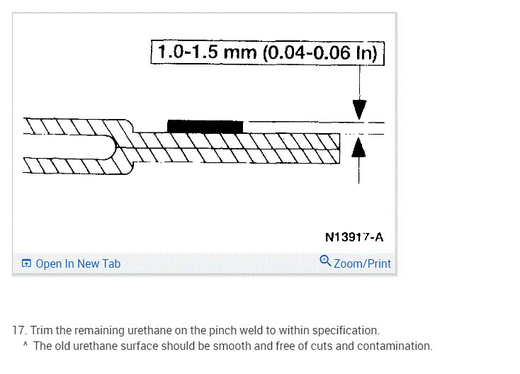

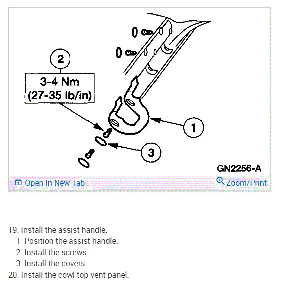

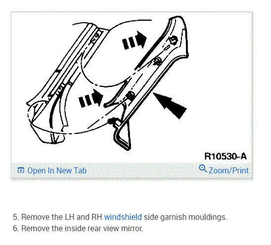

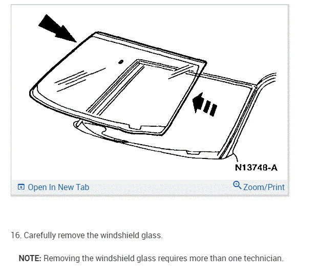

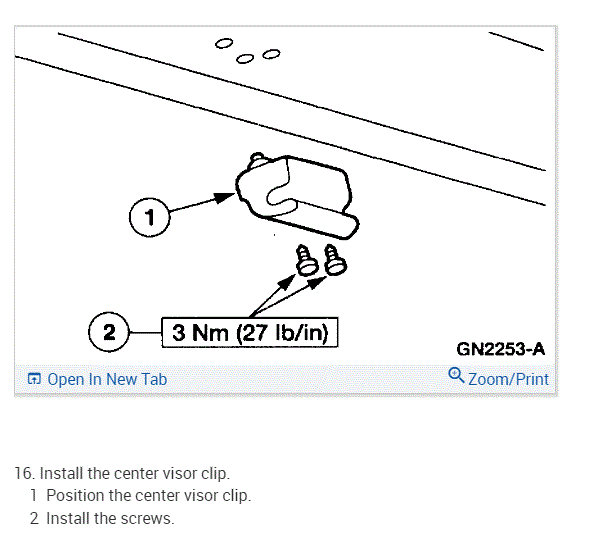

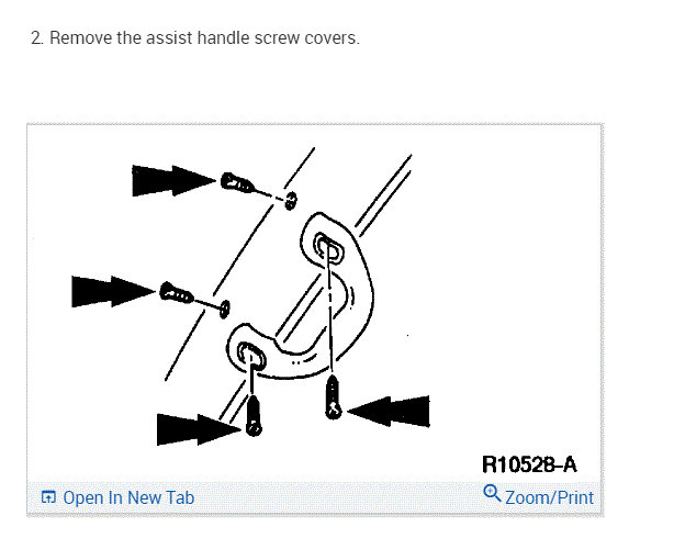

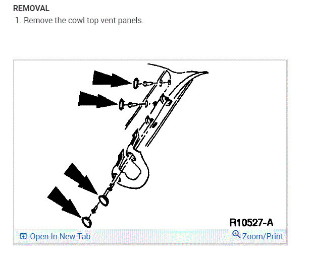

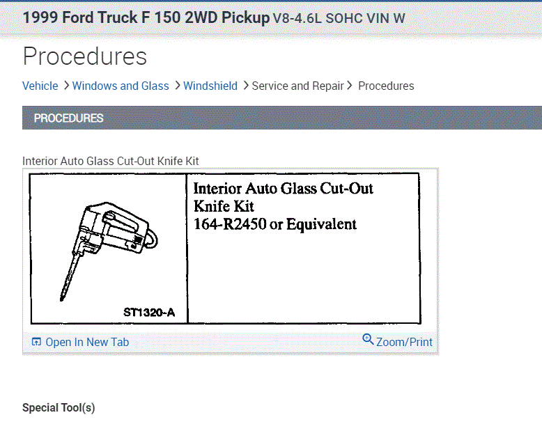

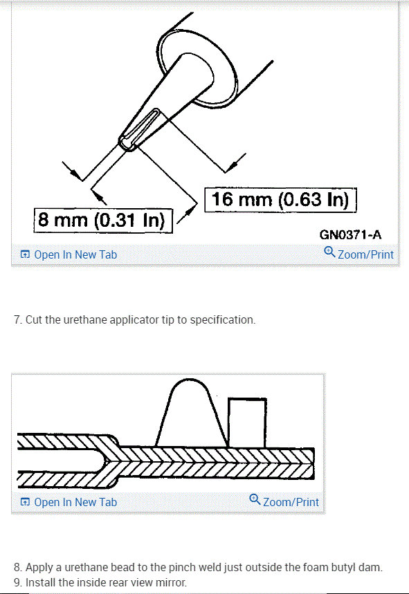

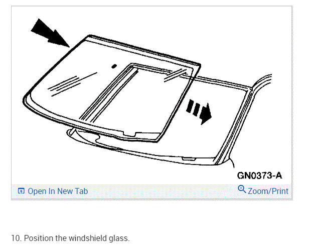

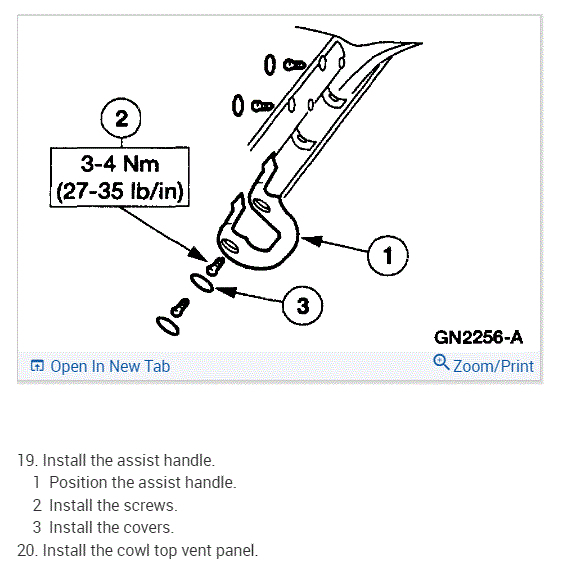

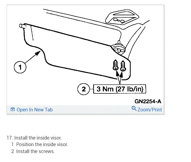

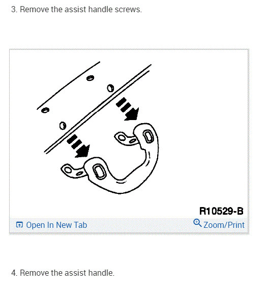

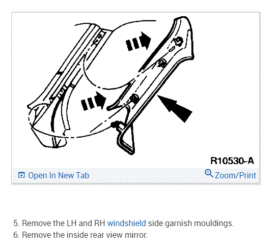

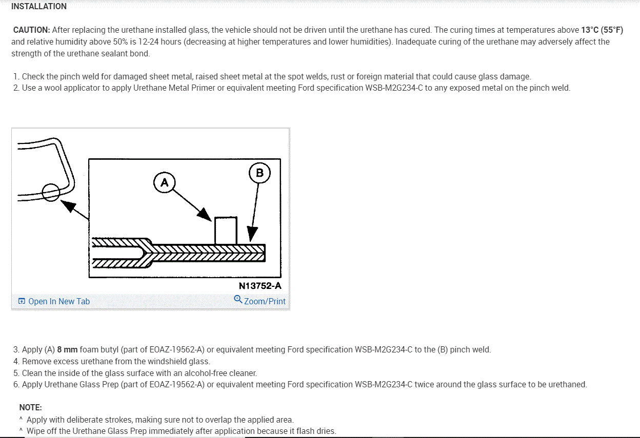

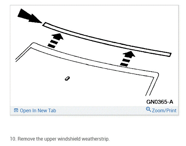

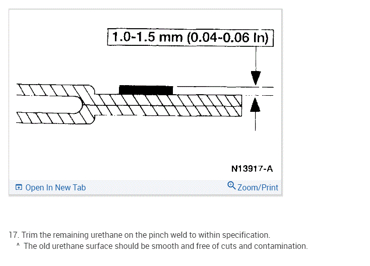

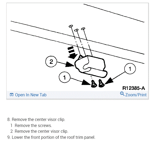

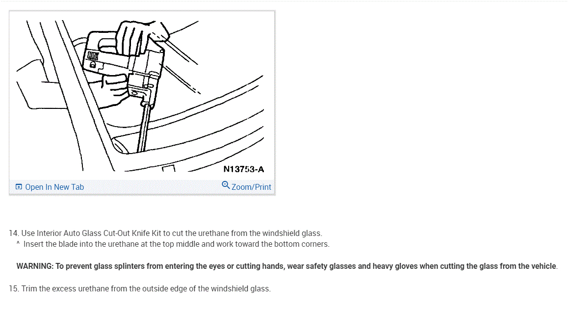

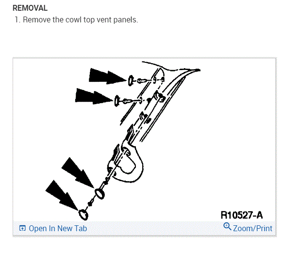

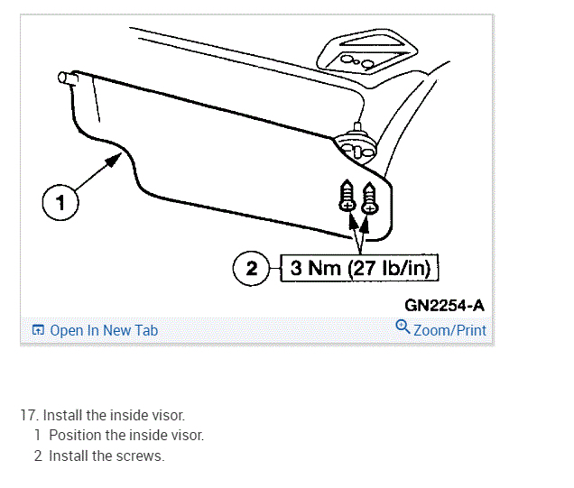

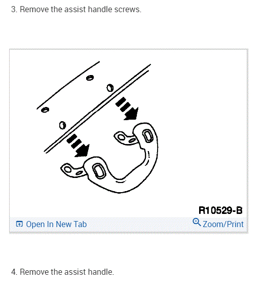

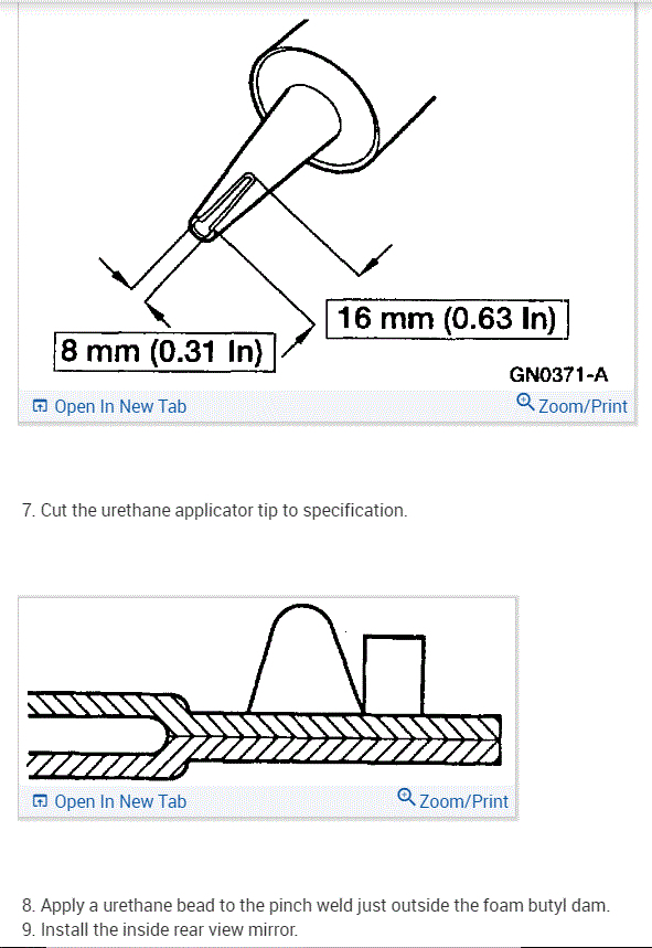

Will a 2005 Ford Explorer windshield fit my 1999 Ford F150?
Tuesday, July 5th, 2022 AT 5:13 PM
MECHANIC
110,194 POSTS
I looked up the part numbers for both vehicles and they are different. So, I have to say it won't work.
I attached the directions for removing and replacing the windshield below, so you have them when you get the new one.
I hope this helps.
Images (Click to make bigger)
