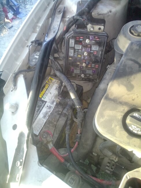

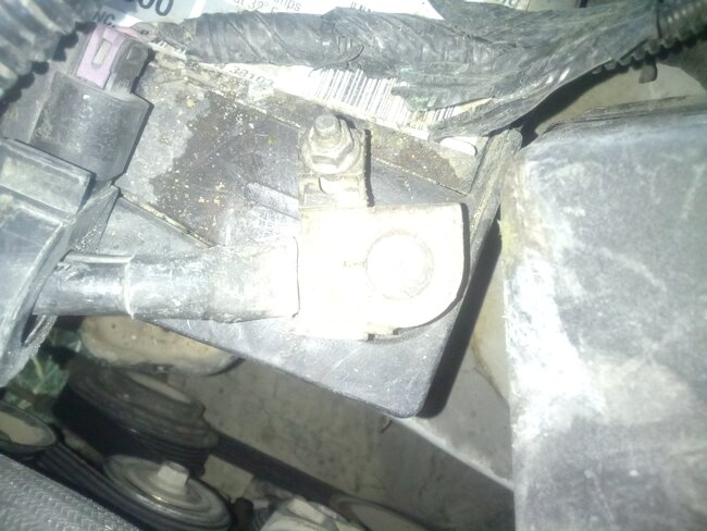

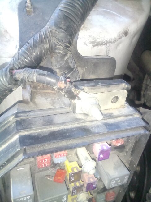

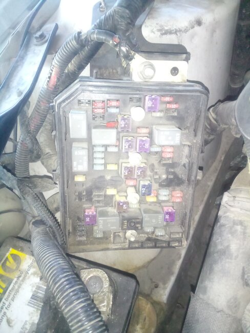

I just replaced my headlights with H11 LEDs with fans. Now my battery is always dead and the bolt that the ground goes to is hot. Also, the LEDs flicker. Are these LED lights maybe causing the issue? Also, I just broke the light bulb in the trunk because it hangs. Could this be the issue?
Here's the hot bolt.
Okay, so won't load a pic because the site won't let me but it's the ground bolt next to battery.

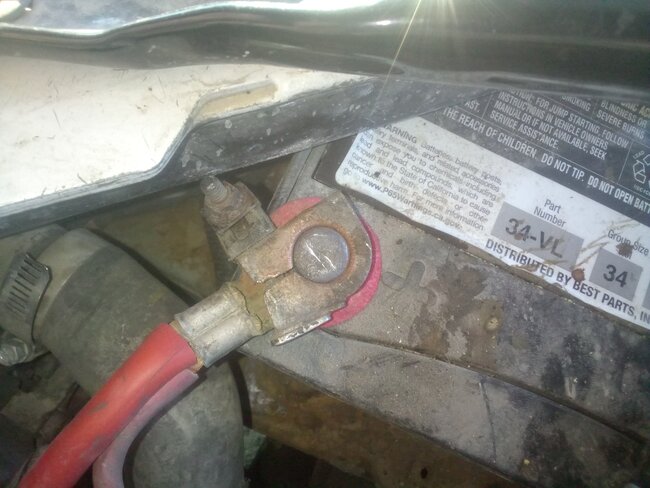

Heat is developed by current flow through an electrical resistance. That resistance is a result of a loose, poor, or corroded connection. The clinker in my story is a less than perfect connection will cause trouble first for the highest current circuits which are the starter, then the generator.
The battery's negative cable will have two wires. The fat one must bolt to the engine or transmission. It handles that high current from the starting and charging circuits. The smaller wire bolts to the body sheet metal. If that is the one that's getting hot, it would explain why the starter is working okay. That smaller wire handles current returning from the lights, fan and seat motors, and all the other electronics on the car. Given the age of the car, rust and corrosion really shouldn't be an issue yet, but it is something to look for.

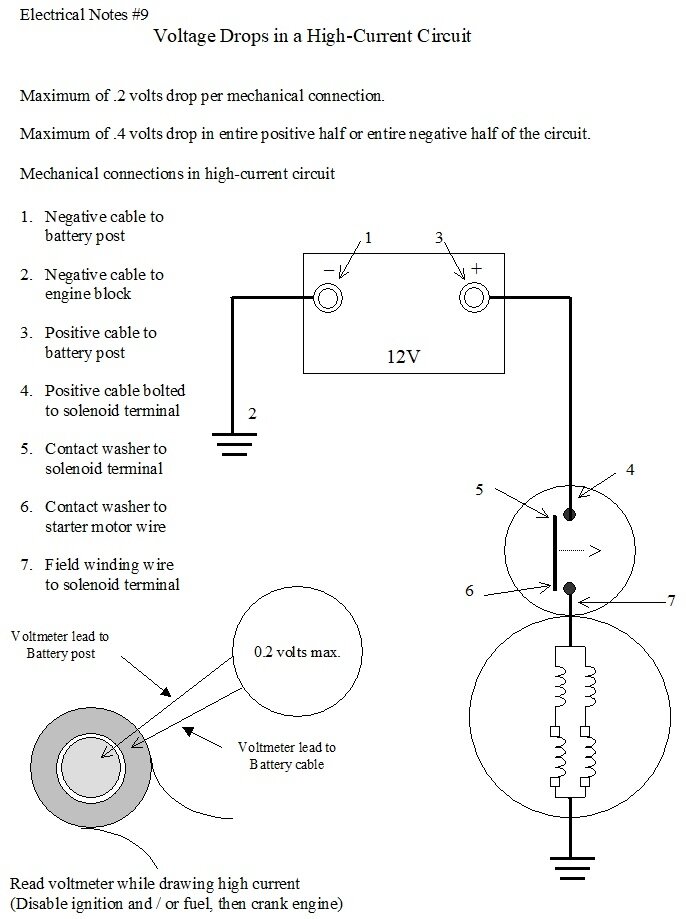

To upload photos, I save them in an MS Word typing document where I can add arrows and callouts, then I copy them into MS Paint where they can be saved in jpeg format. That version can be uploaded. I know there's at least one other format than can be uploaded, but I stick with jpegs because I'm familiar with the procedure.
If the problem is with the cable clamp on the battery, it can explain why the battery is low on charge. There are some easy electrical tests we can do, but they don't work with GM's side post terminals. For now, the best you can do is clean up and tighten any connection that is getting hot.
Let me know if that helps or what you find, then we'll figure out where to go next.

This will work with top post batteries but you'll likely need a helper. I posted a copy of the "Notes" page I handed out in class, for your viewing excitement, but all we care about is the drawing in the lower left. Put one voltmeter probe on the battery's post and the other right next to it on the cable clamp. Logic dictates you should find 0.00 volts there because they're the same point in the circuit, and you'll be right, . . . until you try to draw current through that mechanical connection. The resistance in that connection will be WAY too small to measure, but we can measure the results of it. That resistance will cause a very small drop in voltage when current tries to flow through it.
You'll see 0.00 volts with the meter set to its lowest DC Volts scale. Now have your helper crank the engine. To be more effective, I like to jump the starter relay. That way the engine won't start and you have much more time to read the meter. Another easy trick is to pop the cover off the starter relay, reinstall it that way, then just press or squeeze the movable contact to run the starter. Read the voltage while the starter is running. It should be no higher than 0.20 volts. That's the maximum allowed in any one mechanical connection. The most allowed in total for the positive side or the negative side is 0.40 volts, but still, no more than 0.20 volts per connection. We don't count the connection where the cable clamp is molded around the end of the cable, although those do cause trouble too. Often the cable is corroded away under the insulation where it's next to impossible to see. That's where measuring the entire circuit will show up any hidden undesirable resistance.
This test is valid on ground wires for computer and lighting circuits too, and can identify burned or arced switch contacts. Let me know what you find for voltage drops, but I'm pretty sure you found the bad connection already from the heat.

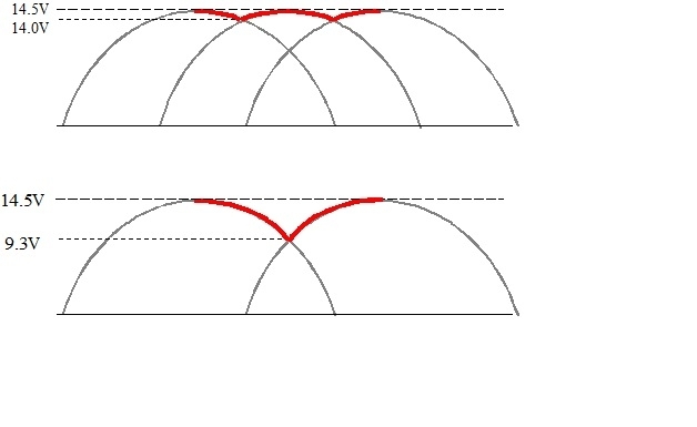

To understand how generators work, three things are needed. We need a piece of wire, (a coil of wire is more efficient), a magnet, (we use an electromagnet because their strength is easy to adjust), and most importantly, there must be movement between them. That's why we have to spin them with a belt and pulley. The generator can be compared to a water pump. It puts the water under pressure. Electrical pressure is voltage, or volts. The faster the water pump spins, the more volume of water it can move. In electrical terms, that's amps, or current flow. The slower the generator spins, the less current it is able to develop.
One of the interesting things about AC generators is they are physically incapable of developing more current than they were designed for, and they will always only develop exactly as much current as the electrical system needs and to charge the battery. You can often install a replacement generator with a higher current capacity, but it is still only going to develop just as much current as is needed. The only time any AC generator will develop it maximum rated current is during the "full-load output current" test I mentioned earlier. That test lasts just a few seconds; just long enough to get the reading.
You won't be tested on this, but to get technical, all vehicles use a type of "switch mode" circuit for their voltage regulator. That allows them to control a fairly high current for this circuit, up to three amps, with a very tiny and inexpensive switching transistor. This works by turning current flow on and off to the "field winding" in the generator. That's the part that spins. That three amps or less is what creates the spinning electromagnetic field. Part of the time that circuit is turned completely off, and part of the time it is turned fully on. That's where the term "switching" comes from. The ratio of on-time to off-time is varied to adjust the average output voltage from the stationary coils of wire along the outside of the generator. More average field current flow means a stronger electromagnetic field, more voltage "induced" into the stationary coils, and with more voltage, (electrical pressure), you get more current flow. Eventually that causes the battery's voltage to rise along with that of the entire electrical system. The voltage regulator monitors that voltage, then makes adjustments to the amount of field current flow as necessary to keep that output voltage between 13.75 and 14.75 volts. Under normal conditions, field current is often less than one amp. That has to pass through the pair of brushes, and being so low, the brushes last a long time.
Without getting too wrapped around the axle with theory, when current flow is abruptly stopped flowing through a coil of wire, the collapsing magnetic field induces a reverse voltage spike momentarily. That is exactly what we want and need for an ignition coil to fire a spark plug, but in all other applications, those spikes can be extremely harmful. Most relays have a diode or resistor across their coils of wire to suppress those spikes which could otherwise reach as high as 300 volts. Sometimes you can feel those jolts if you're touching a relay's terminals when you unplug it.
My reason for troubling you with this explanation is the same thing is happening in the generator each time the voltage regulator turns off. They do that roughly 400 times per second. I don't know why other manufacturers haven't had problems with those voltage spikes, but they have been a big problem for GM. They even use special "Zener" diodes designed to short out those spikes, but they don't do a complete job of that. Because of those spikes showing up in the rotor, they induce corresponding spikes in the output circuit and the entire electrical system. The battery is the main component that dampens and absorbs those spikes, rendering them pretty much harmless. That is, until the battery gets to be a few years old. As batteries age, the lead gradually flakes off the plates and collects in the bottom of the case. With less lead on the plates, there's less material to absorb those voltage spikes. They can still have plenty of power to start an engine, but without the ability to absorb the spikes, those can destroy the diodes and the voltage regulator inside the generator, and they can interfere with sensor signals. In a wiring harness, current flowing through one wire sets up a magnetic field around it, just as it occurs in the generator. By laying next to other wires, that magnetic field affects them too, but as long as current flow remains steady, like with head lights, there's no change, or movement in that field, so no voltage is induced into adjacent wires. It's when those voltage spikes occur that current changes momentarily and voltages are induced into other wires. It's easy to induce a few volts into another wire. A change of as little as a few hundredths of a volt on a computer's sensor wire can mean a lot, and be one very elusive cause for engine running problems. To identify that, we just unplug the small plug on the generator to disable it, then we go on a test drive. If the running problem clears up, it's a really good clue the generator is the cause of the problem.
I already mentioned that with one defective diode of the six, you lose two thirds of the generator's capacity to develop current. In your case that limits you to 50 amps instead of 150. In addition, all AC generators start out by developing three-phase output current which is very efficient. With one bad diode, you lose one of those three phases. If you look at my sad drawing below, the top one shows what three-phase output looks like after it has been "rectified", meaning it has gone one way through the diodes. While one phase is on the downward slope, meaning its current is decreasing, the current from one of the other phases is going up. If you'd graph the output voltage, it would look like the red line at the top. The difference between the highest and lowest points on that line is "ripple voltage". Here's it's very low.
With one bad diode, one phase is lost, as shown in the bottom drawing. Now ripple voltage is very high at 5.2 volts. The battery has to make up the shortfall on current which is why it can slowly run down while you incorrectly think the generator is working properly. Professional load testers can measure that ripple voltage. High ripple voltage and the ability to get only one third of the rated output current go hand in hand and point to the bad diode. It's not likely you'll get one without the other.
You can try to measure ripple voltage yourself, but it will not be accurate. AC generators develop about 12 cycles per revolution, and they spin about three times faster than the engine which idles at around 800 rpm, That puts the generator's frequency around 28,000 cycles per second, or "hertz". Digital voltmeters on the "AC Volts" scale are designed to be used with house current which runs at 60 hertz. Even some military equipment runs as high as 400 hertz, but above that, the accuracy of voltmeters drops off very quickly. The best you can do with a voltmeter on AC Volts on a car is to see if you have some ripple voltage or none. The test is rather pointless because no matter what you find for a reading, you don't know what ripple voltage really is. A better way to check for excessive ripple voltage is to tune your AM radio to a weak station. Ripple voltage will cause a squeal or whine that is very irritating, and its pitch will increase as you increase engine speed.
For the professional load testers, there are a few models that provide an actual voltage value for ripple voltage. Those typically can make printouts of the results. Most models, however, only show ripple voltage as "low" or "high" through a series of flickering lights. We don't know or care what the exact ripple voltage is, just that it's too high.

The first sentence confuses me. I'm not sure what the "4" means. Regardless, we need to address the hot bolt first. That is never a normal condition. Only two things can cause that. By far the most common cause is excessive resistance in the form of rust or corrosion, a loose connection, or some of the strands of wire are corroded off. The less-common suspect is excessive current flow through the connection. Wires will get warm if they're too small in diameter to handle that current. Bolts and terminal studs are usually relatively large in comparison to the wires, so they will be the last things to get hot. In most cases excessive current flows through just one wire due to a short, and that causes a fuse to blow
From what we know so far, the place to start is by disassembling that bolt and anything connected to it, then cleaning and shining up all of the parts, then reassembling them. Once that is solved, see which symptoms remain, then we'll figure out where to go next. If it still gets hot, tell me which things you have turned on, whether the engine has to be running, and if possible, post a couple of photos of it.

I put this drawing together to show how ripple voltage becomes excessive. A pair of diodes passes output current and forms the waveform shown. With the three phases interacting, the top waveform is developed. When the output voltage from one phase is on its way down to "0", the voltage from another phase, and a different pair of diodes, is on its way up to over 15 volts. This is like a three-piston water pump. One piston is developing pressure and water flow while the other two are taking in gulps of water.
Ripple voltage is very low in the top waveform where everything is working properly. It's represented by the red line. The difference between 14.0 volts and 14.5 volts is the exact value, and is what is measured by professional load testers.
The bottom waveform shows ripple voltage when one diode has failed. Here it's 5.2 volts. With the loss of one phase, due to the defective diode being shared at times with the other phases, the generator loses two thirds of its capacity to develop output current.
Even with very old testers that couldn't measure ripple voltage, we can still figure out if a diode has failed by doing a very brief "full-load output current" test. All AC generators, (aka "alternators"), are physically incapable of developing more current than they were designed for. During this test, output current will be the full rated current, no current, or very close to one third of the full rated current. 0 amps occurs when there's some other defect. Full current indicates the generator is working properly. One third indicates a defective diode.
Most vehicles can still be driven with a bad diode, but the charging system won't be able to meet the demands of the entire electrical system under all conditions, especially when the headlights are on along with the heater fan on "high", or the rear window defroster turned on. Once too much current is needed, the battery has to make up the shortfall until it slowly runs down over days or weeks. That is often mistaken for a battery that is about worn out.

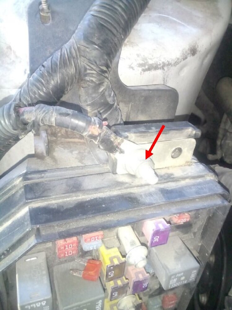

There are two things I can suggest. The first is to check the connection where I added the red arrow to your photo. That one commonly works loose on all car models. It supplies the current for all of the circuits in that fuse box. Everything today uses a computer, including the wipers, and computers are very intolerant of low or unstable supply voltages.
Next is to check the entire charging system. You can start those tests yourself with just the inexpensive digital voltmeter. First measure the battery's voltage with the engine off. If it's good and fully charged, it will measure very close to 12.6 volts. 12.4 volts indicates it is not fully charged, and 12.2 volts says it's good, but totally discharged. If you find it's less than fully charged, use a small portable charger to recharge the battery at a slow rate for a couple of hours. After recharging, turn the headlights on for about five to ten seconds, turn them off, then recheck the voltage.
If the battery's voltage is near 12.6 volts, measure it again with the engine running. Now it must be between 13.75 and 14.75 volts. If it is low, raise engine speed a little and see what happens. If this test passes, it means it is okay to do the rest of the tests we discussed already, but those require a professional load tester. Those tests take just a couple of minutes.
If the electrical system appears to be okay, this should be treated as a wiper problem. Start a new question for that topic so the other experts will see it and have a chance to reply. This could be as simple as a failing switch, frayed wires in the tilt-wheel steering column, or an intermittent computer problem. A scanner is usually needed to see what the computer is seeing and responding to.

The connection you marked with an arrow is clean, no corrosion, and tightly fastened. I just redid all that the other day. I'll do the other tests and check back. Thanks.
