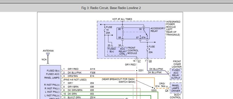

I put a portable heater in my van and it blew my radio and power outlet will not work. Where is the fuse located?

Check fuse 5 in picture below.
Image (Click to make bigger)
