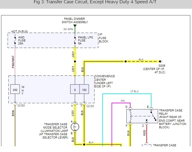

My vehicle won`t go into 4 wd. The indicator light does not come on. I suspect a bad actuator, but am also trying to find the fuse for it. There is not a fuse labelled 4WD. Which fuse is it?

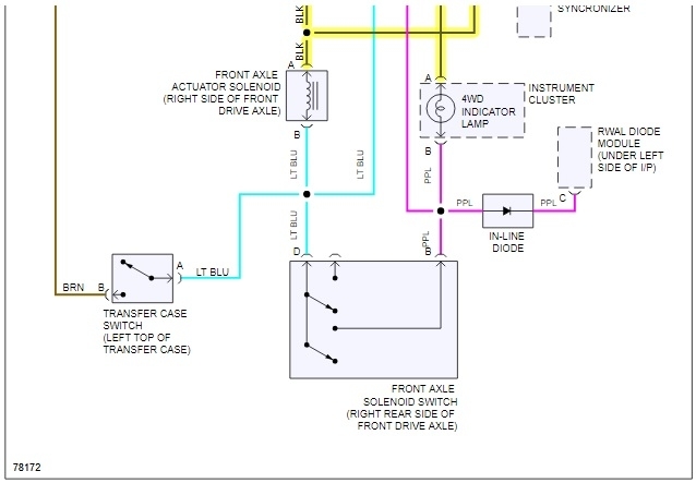

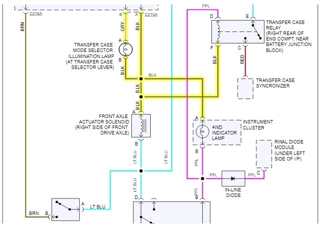

I went into "Prodemand" and using your info I found the wire diagram for Mr. Transfer case.
I had to make three screenshots in order to get the entire diagram.
The 1st is the top portion, the 2nd is the middle, the last being the bottom.
I made sure there was plenty of overlap in each of my shots so that no information is missing (although some is duplicate)
Let us know if this helped you.
The Medic
