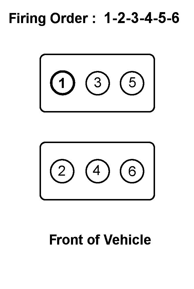

Based on the misfire codes and the engine during order (see image below) I would suspect a faulty coil on cylinder #4. Which slows the crank down to possibly give a #5 misfire. Reset the code and swap #2 and #4 coils around. Drive it and see if the misfire moves to cylinder 2. If it does the coil is faulty. As for P0441 most likely you will need a new charcoal canister since the vapor pressure sensor is not sold separately. But the evap system needs to be smoke tested to verify the roll over valves on top of the fuel tank are not leaking. The TPS code, if it returns then you most likely will need a new sensor.
Do the misfire diagnostic first since that is what you need to focus on first

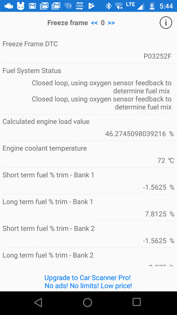

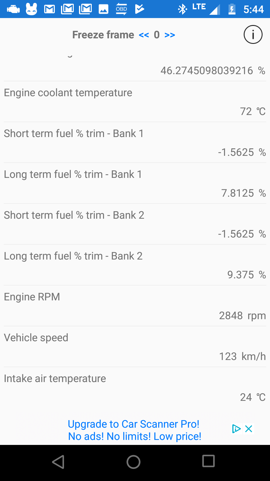

OBD2 keeps freeze framing this. Not sure what it means. Shows the DTC is p0325f. What is that?
Saturday, September 21st, 2019 AT 7:51 PM
JIS001
  • 3,412 POSTS

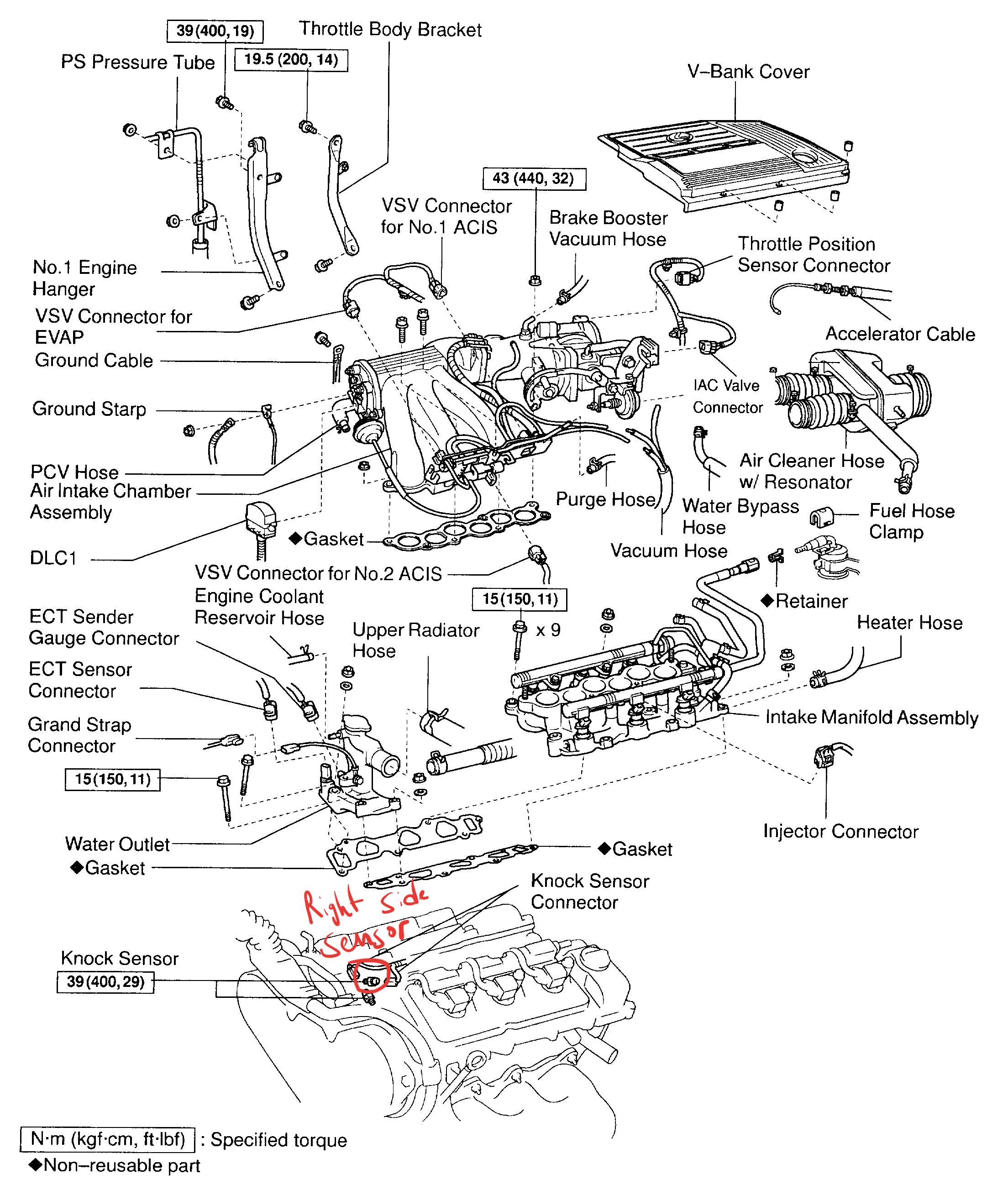

If it is P0325 then that will be for the right side bank knock sensor. What brand sensor did you use? As stated earlier, if it was accidently dropped it makes it useless. And when you say you replaced the harness which harness are you talking about? The engine harness alone can run almost $3000 let us know please.

It could have been dropped when they opened it out the box accidently. That is why I personally get paranoid when handling a sensitive part. But ask your mechanic what brand they use. You may want to use the dealer part to solve this issue. Also what harness was replace? If everything is good then the last thing left to replace is the engine control module. Let us know when you have that information.

Sorry, I wasn't finished yet. We. Just ordered new sensors. The wiring harness for the knock sensors was replaced.
Saturday, September 21st, 2019 AT 9:47 PM
JIS001
  • 3,412 POSTS
What brand sensor did you order? Highlighted the right side sensor for you as well.
