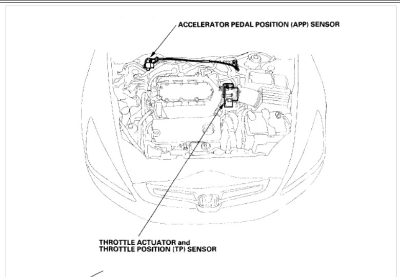

What to do to solve trouble code P0507 - idle air control system higher than expected.

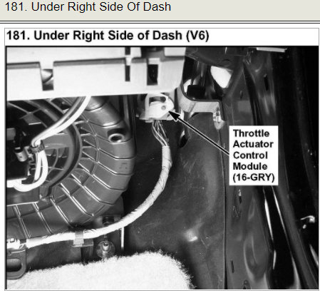

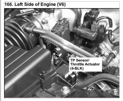

This can be one of two things first a vacuum leak can cause this codes. Here is a guide to help find one.
If no leak is found I would service the throttle body.

Yep that was it the throttle body was so dirty I cant stand it all clean now engine running great codes cleared have not return. Thanks guys!
