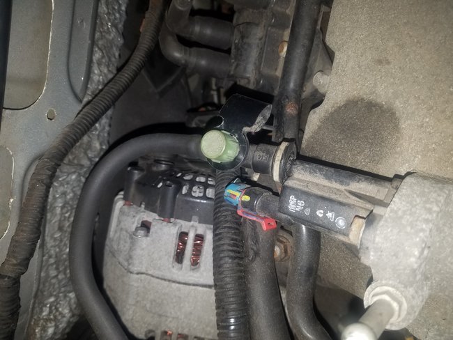

What is the name of this part
GR52VEY
  • 2005 CHEVROLET EQUINOX
  • 3.4L
  • V6
  • 178,000 MILES

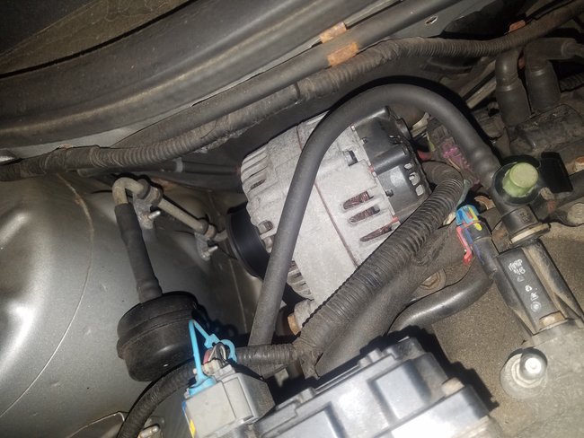

This part is broke on my car and I want to get it fix. Does any body know what is called and the price?
Tuesday, May 29th, 2018 AT 11:25 PM
  • 52,797 POSTS
Good morning.
It looks like the hose is split where the line meets the intake manifold. Is that what you are referring to?
If it is, that is just a piece of vacuum line. You can remove both ends from the manifold and the purge valve and go to a parts store for a piece of vacuum line. The cost should be around two or three dollars at the most.
