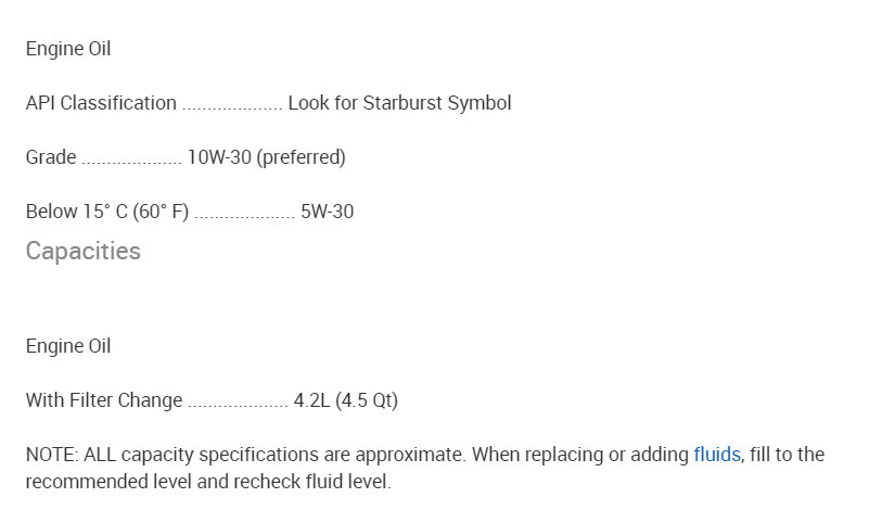

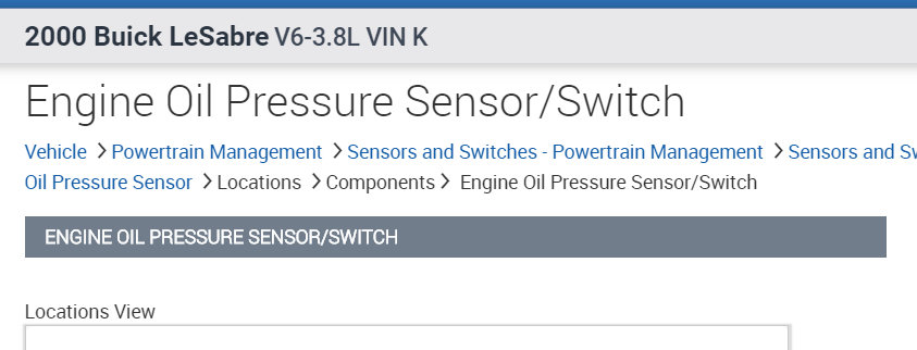

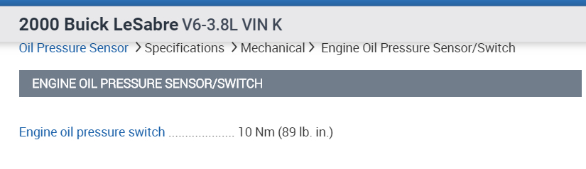

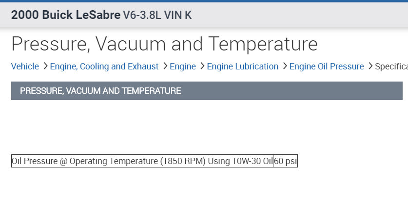

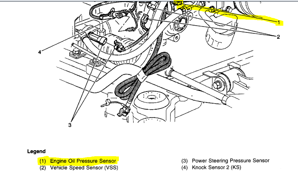

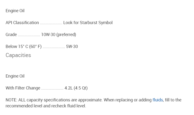

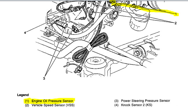

What is it oil pressure supposed to be and if it’s above 80 what could be wrong with it?
Monday, May 20th, 2019 AT 2:51 PM
SCGRANTURISMO
  • 4,897 POSTS

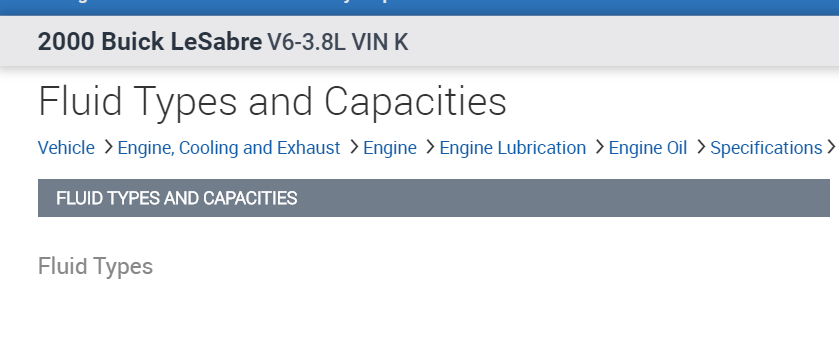

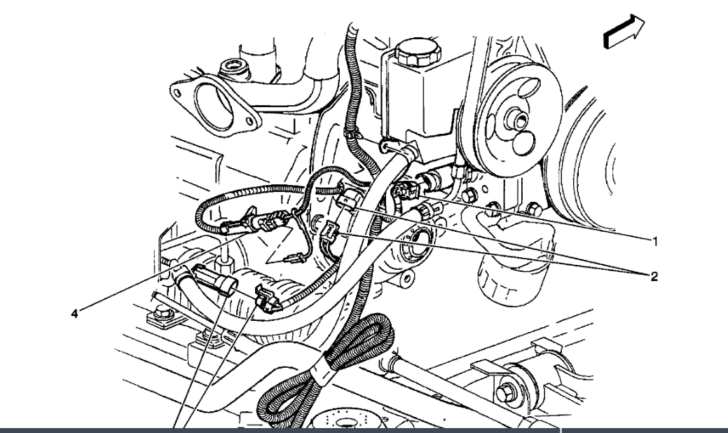

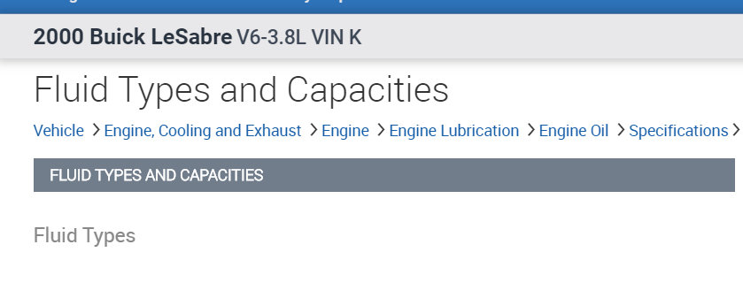

The information you requested is in the diagrams down below. If you have too high of oil pressure I would double check to make sure that you have not overfilled the engine with too much oil. I would also ensure that I have the right viscosity oil in it as well. I have included the oil capacity as well as type in the diagrams down below for you as well. Please get back to us with what you are able to find out.
Thanks,
Alex
