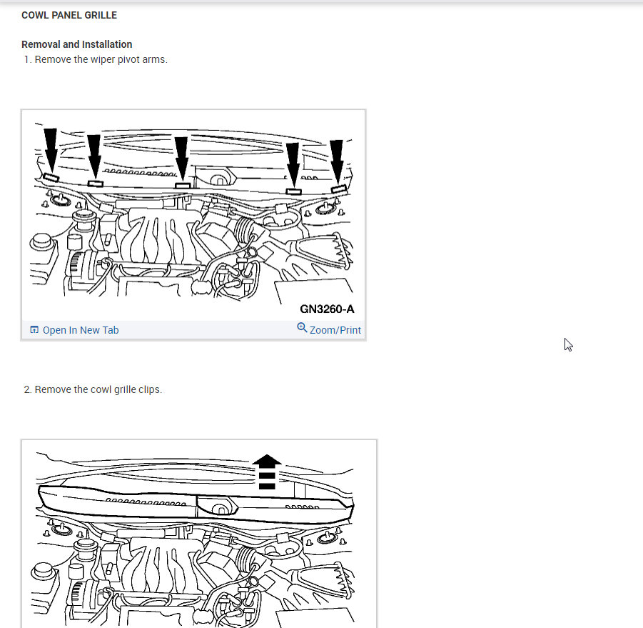

The drivers side floorboard is soaking wet when it rains. The car is parked and has not even been driven. Just the drivers side. What is causing this?
Monday, September 26th, 2016 AT 5:53 AM
Do you have a sunroof? If you do then more then likely the drain is clogged. If you do not then you have a seam that is opened up on the firewall.

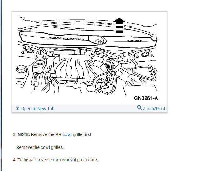

You will need to remove the cowl panel and start water testing to find where the water is coming in. I attached the process for removing the cowl panel.
