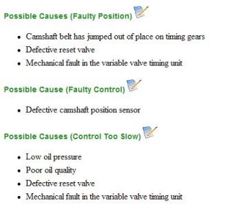

I have 1999 volvo s80 turbo. I have obd2 code p0014 it says (Exhaust Camshaft Position) code. What do I have to fix to get rid of that code.
Thursday, March 26th, 2009 AT 12:44 AM
BLUELIGHTNIN6
  • 16,542 POSTS
There are several things that may cause this code to appear. You will first need to inspect a few components before replacing anything. However, the most common culprit here would be a faulty camshaft position sensor. A list of possible causes are below..
https://www.2carpros.com/forum/automotive_pictures/261618_Noname_363.jpg
