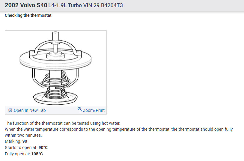

Went to AutoZone for diagnostic check. Code came up that engine is running too cool. Car seems to be less peppy. The fluids are all proper levels. Need help. Any suggestions?
Friday, January 15th, 2010 AT 7:34 PM
SQM
  • 6,383 POSTS

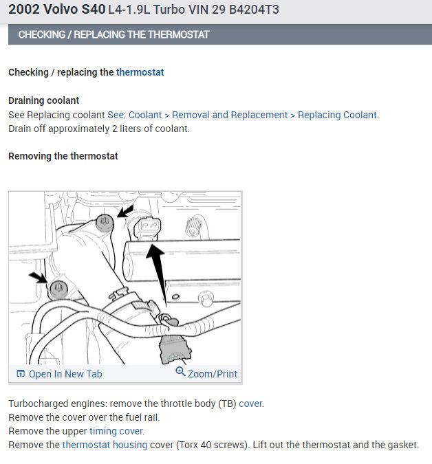

Anytime the engine run cooler than it should, the first item needs to be checked is the thermostat.
If you have a stuck open thermostat it will not allow the engine to reach the operating temperature and the engine will run cooler.
https://www.2carpros.com/articles/how-an-engine-thermostat-works
Remember to only work the cooling system of the vehicle when the engine is cold.

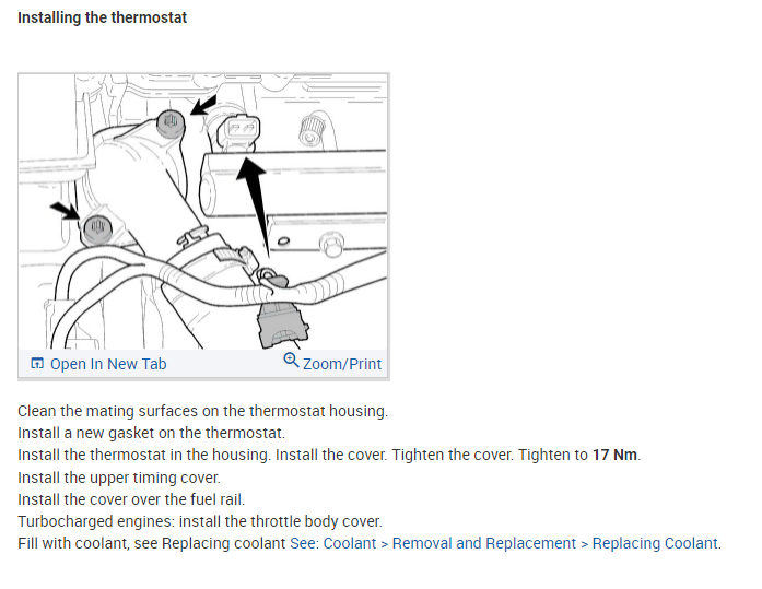

I have attached the thermostat replacement diagrams.
