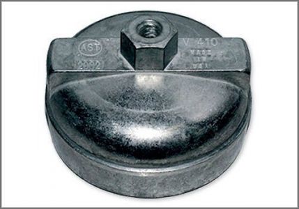

What is the best oil filter wrench to use to change the Oil filter with and is the oil cover cap a twist off type?

The oil filter is inside of a black, plastic canister which screws off. The oil filter is a cartridge type filter that you lift out.

The tool needed 86.5mm Oil Filter Wrench
AST tool# V 410
- 86.5mm with 16 flats
- Included in the 2100 Oil Filter Wrench Kit
- Made of Aluminum
- Durable
