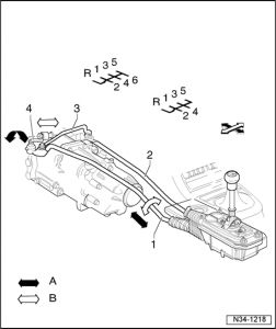

Hi there,
The gear box uses a remote type selector, that is the gear stick selects the gears via a set of control rods, the fault may well be in the selector box, your mechanic will have to inspect this for you.
Mark (mhpautos)
