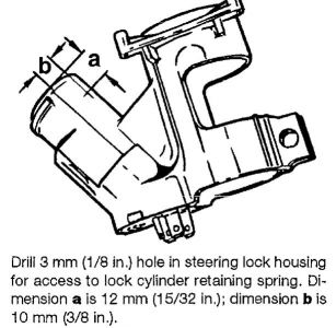

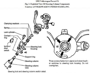

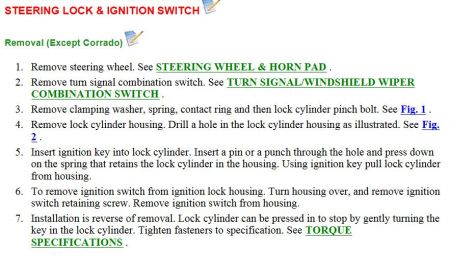

how to change de key switch

Hi joseluis,
Hope this helps.
