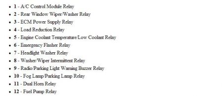

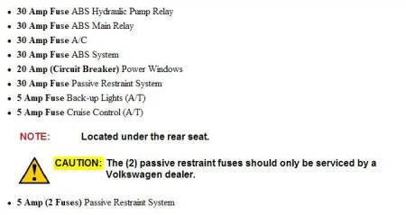

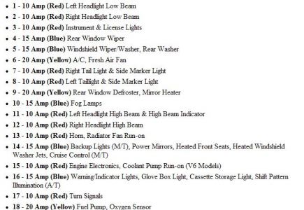

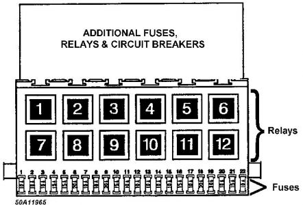

I need pictures or diagram of fuse box 5 speed thanks

FUSES IDENTIFICATION
RELAYS IDENTIFICATION
ADDITIONAL FUSES/RELAYS/CIRCUIT BREAKERS IDENTIFICATION
